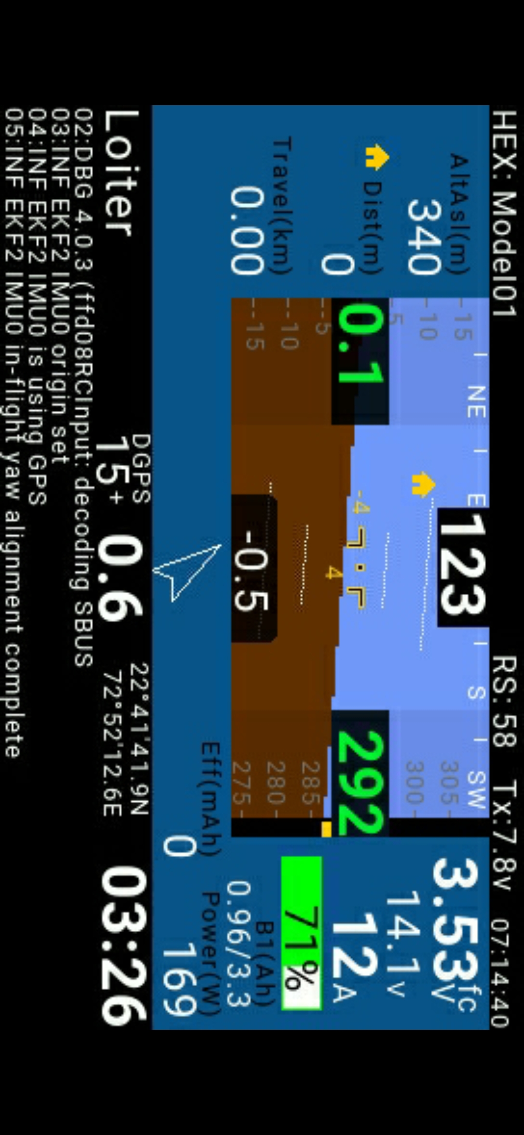

Ohhh my god , there is something wrong with my copter.
This is video to test with 6s but it seems consume unexpected amps
And when I’m flying on 4s then I reach whatever high it consume no more 15amps i know that :thinking: (when tack-off time 20A max with payload)
This screen shot taking at “28-3-2020”
How it’s possible :dizzy_face::dizzy_face::dizzy_face: I’m confused.
Thank you :slightly_smiling_face:
what FC do you use ?
maybe you need to recalibrate the power consumtion
