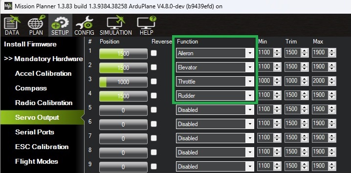

The problem is in the mapping, I’m not sure how to map each function to the appropriate serial connector, and no matter what I try I can’t get it correct. I’ve plugged in the 2 motor connectors to S1/S2, the Ailerons to S3/S4, and the Elevator to S5, then mapped the function I’d expect.
Can anyone give guidance on how this is supposed to work?
Thanks
Can you share your parameter file?
Normally you would just set the SERVOx_FUNCTION
Nothing wrong with QGC, but I think Mission Planner makes it easier…
