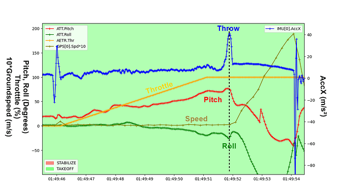

Hello. I’m struggling to hand-launch an AR-Wing Pro in take-off mode. I’ve failed four times so far, and the nose is starting to get pretty worn out. It always follows the same pattern: after launch, it suddenly rotates to the left and crashes headfirst. Previously, when I flew this aircraft with iNAV 6.0, I was able to take off without any issues. I’m getting flash data, so could you take a look at it?

Some configuration is incorrect. Post a link to the .bin log file.
Thank you for your reply.
I will share the Bin file of my crash. Here you go.https://drive.google.com/file/d/1oFamtwYKZGByM59ysz1_z7A8edVmVvDT/view?usp=sharing
It’s torque roll. Change TKOFF_THR_MAX to 80% or even less. TKOFF_THR_DELAY to 4sec.
I think it’s natural to turn left with a torque roll, but the aircraft is already heavy (4 cells of 5200mAH Lipo) and the wind doesn’t pass over the wing, so I think there’s a chance that the aircraft won’t lift off if I lower the throttle. Since the aircraft takes off normally with the same iNAV Throttle setting (100%) and Motor Delay (100msec), I think the cause is a delay in elevon control, including torque roll response.
Sorry, but ardupilot would not be able to fly at all if there were a delay of this magnitude in the Elevon control system.
I suspect that you threw the plane too steeply into the sky. When thrown, the pitch (red line) exceeds 75° and then drops to around 45° within the first half-second. Imagine trying to drive your car up a 45° incline and accelerate at the same time. You would find that the acceleration is significantly lower than when driving horizontally.The roll angle was already over 45° and the ground speed is around 4 m/s.
From my experience, throwing at a flatter angle makes more sense, particularly during automatic take-off. This is because acceleration is significantly better and there is a higher probability of exceeding the stall speed earlier.

Thank you for your very convincing explanation. I may have angled it too high. I launch from the back so it’s difficult to adjust the angle, but I’ll try not to raise it too high as much as possible.
