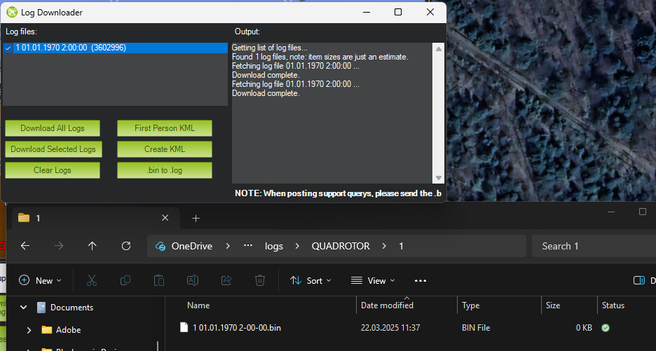

Can't download logs via MavLink - 0 bytes
I do “first flight” on SpeedyBee f405 mini. And want to analyze logs.
Arducopter 4.5.7 (the same on 4.6.0-beta)
MissionPlanner 1.3.82 build 1.3.8979 (the same on beta 1.3.9151)
LOG_BACKEND_TYPE=block (internal flash).
I can see that log exists (3,7Mb):
But on downloading I get 0 size file.
Logs from the Mission planner ConsoleL:
INFO MissionPlanner.Log.LogDownloadMavLink - GetLog 1

INFO MissionPlanner.MAVLinkInterface - start fillin len 0 count 1 datalen 0
INFO MissionPlanner.MAVLinkInterface - set count 1
INFO MissionPlanner.MAVLinkInterface - count total 1
INFO MissionPlanner.MAVLinkInterface - totallength 0
INFO MissionPlanner.MAVLinkInterface - current length 0
INFO MissionPlanner.MAVLinkInterface - set giveComport Log download single thread current False new False
INFO MissionPlanner.Log.LogDownloadMavLink - about to move C:\Users\anton\AppData\Local\Temp\tmp7A6E.tmp to: C:\Users\anton\OneDrive\Documents\Mission Planner\logs\QUADROTOR\1\1 01.01.1970 2-00-00.bin
INFO MissionPlanner.Log.LogDownloadMavLink - about to GetFirstGpsTime: C:\Users\anton\OneDrive\Documents\Mission Planner\logs\QUADROTOR\1\1 01.01.1970 2-00-00.bin
Binary: False
DFLogBuffer-linecount: 0 time(ms): 0
Try QGControl
Download and Install | QGC Guide (master)
Setting the Writing rate for block devices as 10 helped, I guess. thx!
