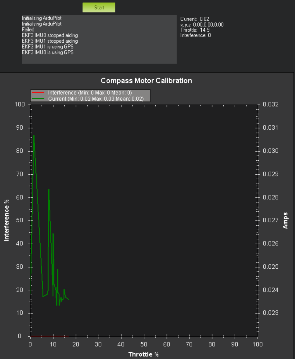

Whenevr i am going to do Compass motor calibration i am getting the following error
EKF3 IMU0 stopped aiding
EKF3 IMU1 stopped aiding
EKF3 IMU1 is using GPS
EKF3 IMU0 is using GPS
then i am getting GPS unhealthy error
my setup : CUAV X7+, CUAV C-RTK 9Ps(single antenna), H16 RC, 18000mah 6s4p Li-ion battery, 4114 tarot 320 kv motors, sunnysky 50A ESC
i need a solution and understand whats happening here, i even cant do my motor tests, the motors just dont spin

Well, that would be the 1st problem to solve. Magfit has replaced Compass Motor Calibration anyway.

No. But, if the motors don’t run in Mission Planners Motor Test there is no point in doing anything else. Typically there are error messages shown for why it doesn’t run.
True, but is it of any concern? because the motors function perfectly otherwise, if armed separately

I think you should reset to default and start over with the Methodic Configurator. @amilcarlucas can perhaps guide you.
