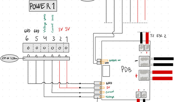

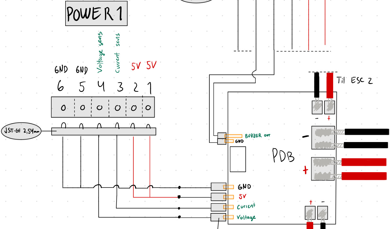

Hi
I’m having some trouble getting current reading in mission planner. I have tried changing a lot of parameters, and nothing seems to work. I’ll list all hardware and parameters changed.
  • Cube orange
  • Smart AP PDB with current sensing
  • Using the Volt and Current sensing pin on PDB to the right pins on POWER1 of the cube
  • Battery current and volt pins set to the right number (15 and 14)
  • For battery monitoring i choose cube orange, analog current and voltage and «other» for HW.
  • I have followed Smart AP’s reccomendations for offset, pervolt etc.
I get voltage reading of battery (~55V) and have managed to tune the current that is showing on screen to be 0A, but it doesn’t respons to throttle. Anyons have any ideas?
Post your .param file. Or even better a .bin log file.
.bin file was apparently too big, but i downloaded the latest one. Link also includes parameter list
Parameter list.param (19.2 KB)
