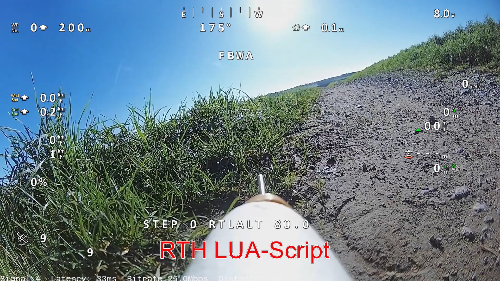

Since I often also stand at the edge and launch the plane onto a meadow, two years ago I wrote a LUA script for this and personal purpose (and therefore it’s spaghetti code).
It does the following: After take-off, it moves the home point (HP) to where the departing aircraft has travelled a configurable distance from the original home point.
However, it does even more (as a result of negative experiences):
In mountainous terrain, the plane can still fly behind a mountain, which can trigger the RC failsafe RTL. This carries the risk that the RTL_ALTITUDE might be set too low, which could lead to a CFIT into the mountain.
Therefore, when RTL is triggered and the aircraft is flying lower than RTL_ALTITUDE, it first climbs loitering until it reaches RTL_ALTITUDE, and then flies back to the new HP.
If you take off from a valley and set a high RTL_ALTITUDE for safety reasons, you don’t want the aircraft to end up RTL-circling very high above the HP. So you can specify a lower altitude using the new RTH_ALT2 parameter, which the aircraft will descend to as soon as it reaches the home point.
Two additional parameters are set:
DIST_MOVE_F is multiplied by RTL_LOITER_RAD to determine the distance from the starting point at which the home point shifts.
DIST_ALT2_F multiplied by RTL_LOITER_RAD determines the distance from the new HP at which RTL_ALTITUDE changes to RTL_ALT2 during the return.
Here’s the script, zipped, assuming you can handle the spaghetti code.
HP_MOVE _NEU.zip (1.8 KB)
