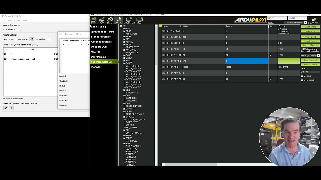

I am running a couple A8-X motors from Tmotor through CAN but I’m only getting rpm data at 1Hz, how did you get the rpm feedback frequency high enough to use it for rpm filters? I guess you need about ~100Hz to make it work?
I guess you need to setup the rate in your esc config @tridge explains here
Had a look through the parameters over CAN and through their own programmer. Can’t find any parameter for it, only for acceleration, braking LEDs etc
Probably need a new firmware with user configurable telem rate
