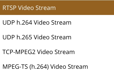

Hi guys Iām planning to connect a camera model with my pixhawk cube orange plus. But could find any proper page for the video stream.Can any tell me how to work in RTSP, UDP, TCP-MPEG2, MPEG-TS
Hi @Suseendhar_Raj,
Thanks for using AP.
Which camera gimbal are you using? In any case, the RTSP stream iwht UDP h.264 or h.265 is the one to use. The stream does not go through the autopilot though, it needs to be accessible from the ground station normally using ethernet.
We have some information here on the wiki:
- MP live video: Live Video ā Mission Planner documentation
- Siyi Ethernet Connectivity: SIYI A8, ZR10, ZR30, ZT6 and ZT30 Gimbals ā Copter documentation ā includes images of how to show live video on QGC
- Ethernet connected vehicle: Ethernet Connected Vehicle Example ā Copter documentation
Hope that helps
