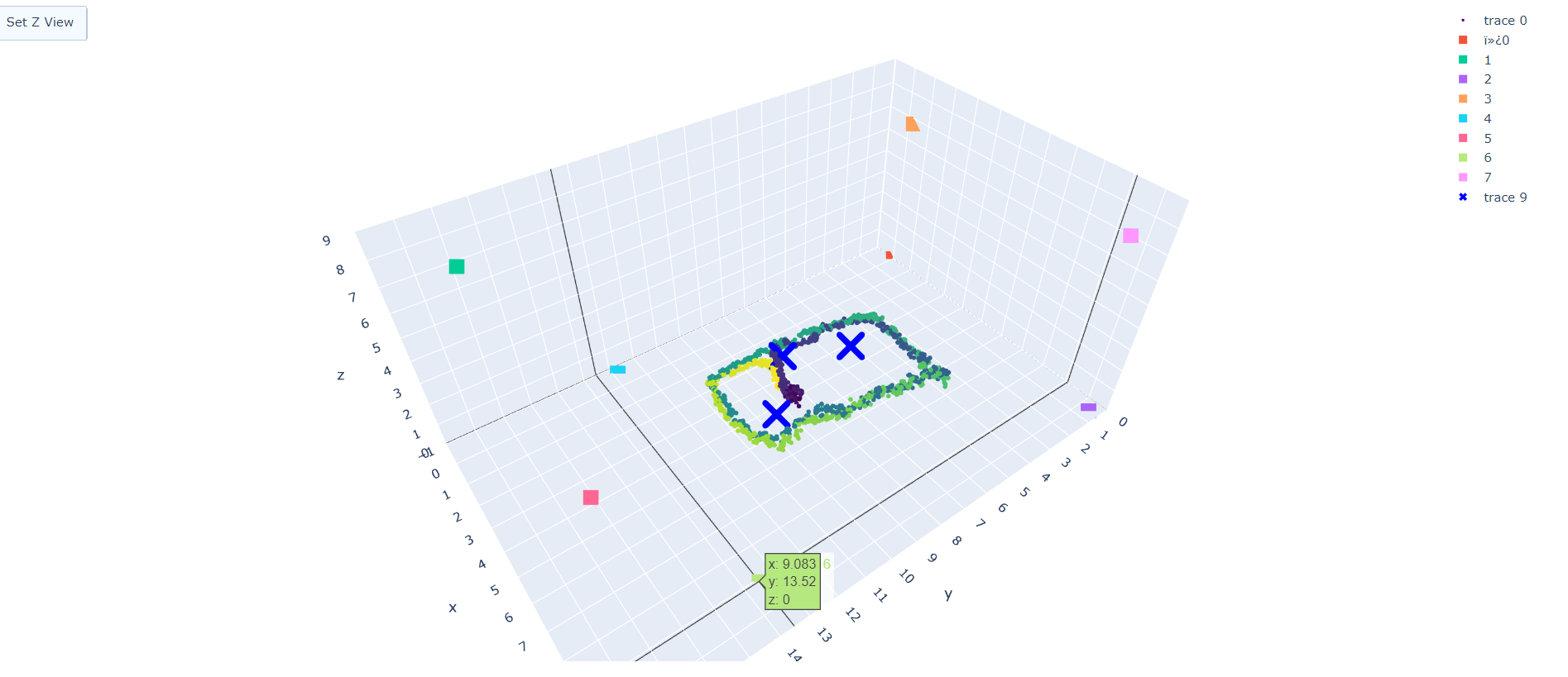

-3d Map :
Our UWB system has also been very well received graphically . As I say in the previous post , through the custom High Frequency log that I added , I was able to create a python script that would analyze the log saved by the drone and create a three-dimensional (interactive) map , which displays both the coordinates of the UWB anchors , and the path taken by the drone during the acquisition of the log , just thanks to the info : X,Y,Z . Here is an image of the map :
