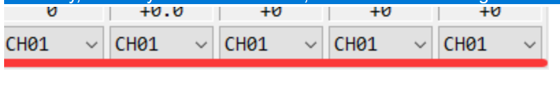

I have been talking with caddx and this is what they have said so far, " Dear Customer
Thank you for your reply. Firstly, after numerous practical tests, we did not find the compatibility issue you described.
You can first confirm whether you have changed the channel to CH01 in the software after upgrading the firmware to V3.6, instead of leaving it blank.
Secondly, what is your control method, is it transmitted through PWM or UART protocol?"
ArduPilot control is via the UART protocol.
Yes I am aware of it being controlled via uart. I am not home to test but they have said they have no issues using latest arducopter with the gm3 and 3.6 and they have changed “nothing” that would have broken compatibility from 3.4 to 3.6. Again that is caddx themselves saying that.
Did a quick test and indeed setting CH01 fixes this issue. I can again control gimbal over uart. But… only to first reboot after getting out of gimbal config tool. EDIT: Because I was too stupid and skip “Save params to flash” button. :slight_smile:
