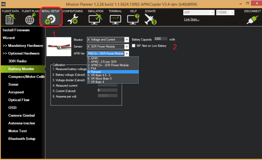

Dear Mark,
What shall I select in the place of Monitor, Sensor, APM Ver and how to fill the fields of calibration ?
You had been an excellent guide for me.
Thanks
Pretty sure it is voltage only and px4 … it is in this thread somewhere if you work up - and also you have my parameters to compare settings with
