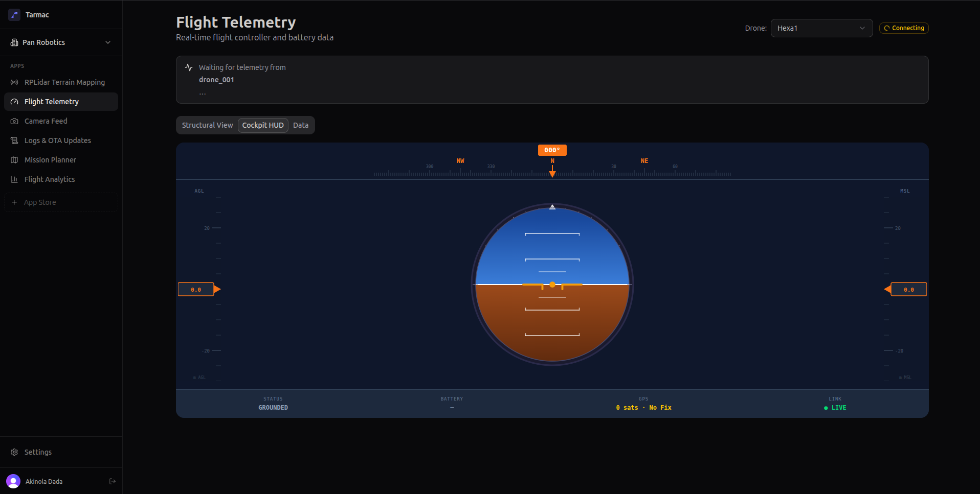

A lightweight Python service runs on the companion Pi, connects to ArduPilot over MAVLink via MAVSDK, and streams a full telemetry dump — attitude, position, GPS, battery, IMU, RC status, actuators, flight mode — to a web dashboard in real time. A second service handles a job queue so you can push missions, pull logs, change parameters, or trigger OTA firmware updates from a browser without needing to be on the same network.

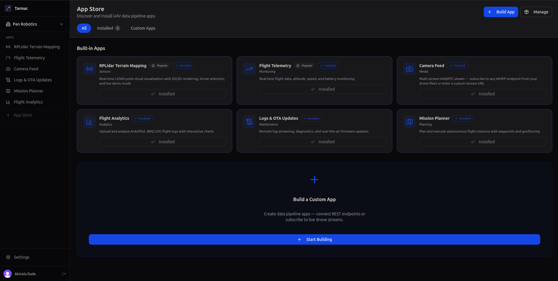

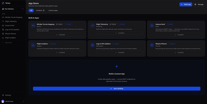

The part I think is actually interesting — the App Builder:
The bigger idea is making custom payload integration accessible to people who aren’t backend developers. Right now if you’re flying something non-standard — a custom sensor, a smart battery, a gimbal, a lidar, a gas detector, whatever — getting that data into a usable UI typically means writing your own ingestion pipeline, your own storage, your own frontend. That’s a significant lift for most operators and it means a lot of good integration work never gets shared.
The App Builder is an attempt to close that gap. You define a data schema and a lightweight parser function for your payload, and Tarmac generates the REST ingestion endpoint, handles storage, and builds a live UI widget from it automatically. The companion-side script is a single Python file. The goal is that integrating a new payload goes from a multi-week project to an afternoon — and that those integrations can be shared across the community rather than everyone rebuilding the same thing independently.
