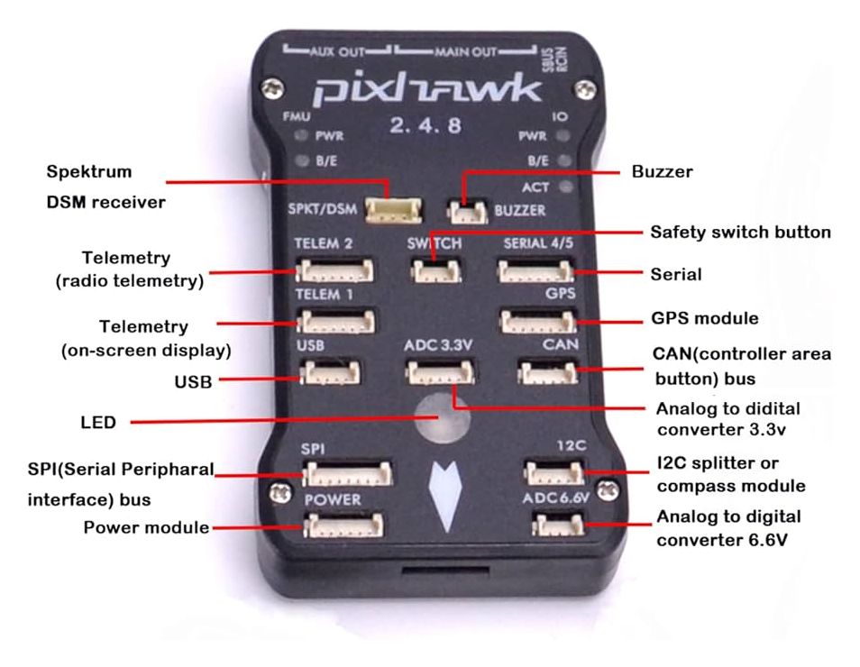

I use Pixhawk 2.4.8 controllers, they’ve proven steady and reliable and I like them. Only on the odd occasion I get one of these hiccups usually resolved fairly quickly.
