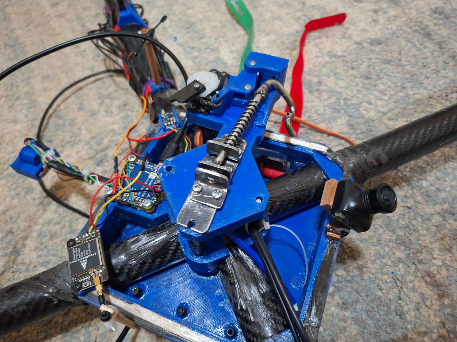

OK. I was doing some hardware work and came up with the following:

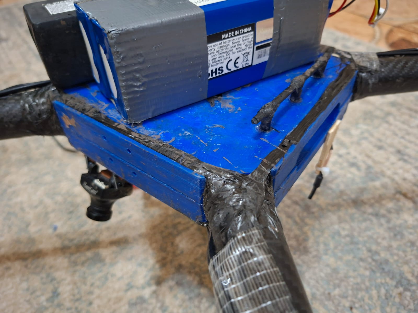

This is my new copter… it has a diagonal of 106 cm, is based on 1 mm thick 30 mm tubing, and 3d printed frame with carbon fiber tow inserts (basically, the printed frame serves as a mold for making the frame which allows obtaining very lightweight frames, I impregrante carbon tow and then wrap it around the groves, which here are 5 x 7 mm both on top and bottom). Weightwise, frame, motors, esc, props, electronics, capacitar bank, cables, etc, weighs 1700 grams. Excluded is the release mechanism, which weighs 200 grams with servo and everything. And the compound 6S battery with total capacity of 8000 mah (Lipo) weighs close to 1400 grams. So overall, 3300 grams, about 10 % over the inital weight budget. The props are 15 x 4, and are very heavy, 45 grams each. I can replace them by 15 x 5.5 EOLO props which weigh 17 grams.
Today I had my first hover test which went OK, got 22 A at 23 V and 3100 grams, about 10 % more than predicted by the Ecalc. At 10 kg, the current should be around 120 A.
To exclude any possibility of overheating I placed the 60 A x 4 ESC directly under the prop tip for cooling. Next days I will try to load the copter and obtain more data on power and temperatures for heavy load.

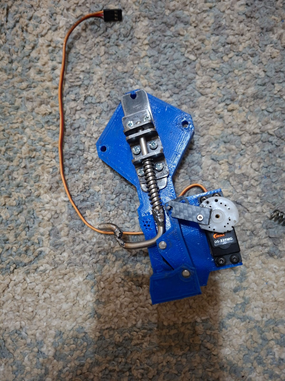

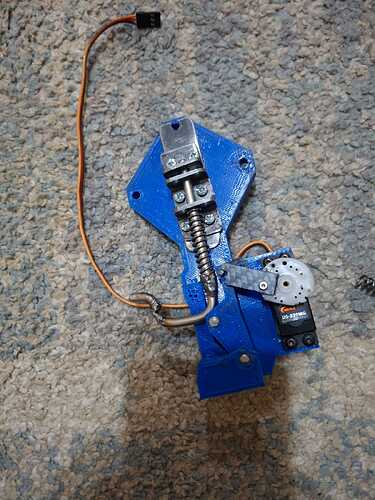

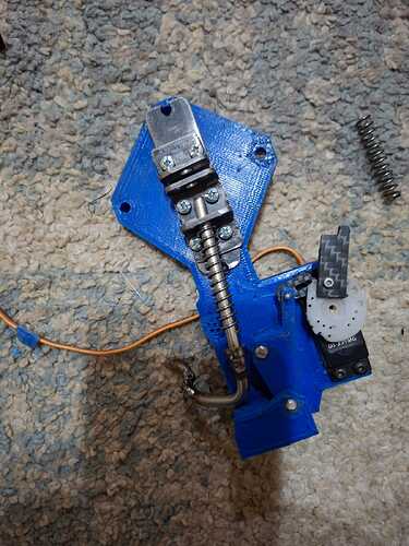

The release mechanism also works very well, the spring has a tension of 7 kg, i.e. based on the estimates for pin friction etc., it is good for release of at least 15 kg load. Maybe I overengineered the whole thing here. It has a safety latch, and a cable which pulls the latch (not shown on the photo). I used a 32 gram servo, 4 kg cm nominal, but the force necessary to release is very low, I would say that even 12 gram servo would work here.
