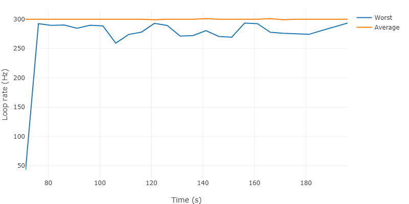

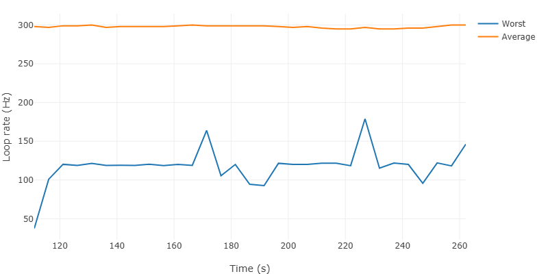

Well I think I’m in for some more learning - had a few flights today with multiple distinct aircraft of the same construction where we all had a similar issue, but mirrored, in a way. Myself and one student had our planes give large amounts of uncommanded right yaw in FBWA mode, while two other students had the same things occur, but with left yaw. Some of us were able to fly normally for a minute or two before the aircraft just started to perform its yaw/turning on it’s own. I don’t know what is causing this. I originally thought it was motor misalignment, but I have checked that and all motors are facing straight forward mounted on the foam board wings. The other thing that really stood out to me was the split with two aircraft turning right on their own and two turning left. The only significant physical difference between the aircraft is that two of us have our batteries mounted on the LH side of the center fuselage/strut and two have batteries mounted on the RH side. But I wouldn’t think this would make a significant difference, and if I remember right, that RH/LH battery mount distinction did not line up with the RH/LH uncontrolled yaw we saw in flight.
I’m really at a loss here on what could be causing this - is it something to do with our frame being setup as an “X” quad? Something with a compass anomaly? I don’t really know where to start so any help would be greatly appreciated.
Folder with 4 log files from 4 distinct aircraft, though all are nearly identical in construction/layout.

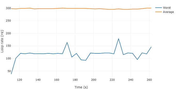

Two of the the logs from vehicles using the MicoAir405v2 flight controller have very bad loop rates.
That inconsistency will cause issues in the control system.
The other two are better:
The key difference in params seems to be OSD.
By default there is no active yaw control in forward flight. You do have differential thrust setup from the VTOL motors, this is only driven by the pilots yaw stick.
You could enable active yaw control/damping as outlined on the wiki:
A bigger hammer would be to enable the VTOL rate controller in forward flight. You could set the two Q_OPTIONS given here: Tailsitter Planes — Plane documentation

Checking my understanding - disregarding the OSD parameters that seem to be causing bad loop rates, would you say that the main issue here is that I was expecting yaw to be stabilized with the differential thrust, but this is not the case in Arduplane by default?
Because the planes keep turning “by themselves” would this point to a physical imbalance in motor speed/output or airframe variations that then leads to them in essence “needing some trim” if this were a manual non-flight controller type vehicle? e.g some type of twin engine fixed wing model.
Thank you for pointing out two methods of remedying the issue. If I understand it, I could setup and tune the yaw damper on the aircraft, or I could set one of these two Q_OPTIONS up. Do you recommend any pros/cons of either? the Q_OPTIONS method seems a bit more straight forward - I’m leaning towards Q_OPTIONS bit 8:Mtrs_Only_Qassist just based off a quick look.
Right. On a “normal” model you would trim it with the rudder servo.
The Q_OPTION method would be quicker to test. It just takes you away from a traditional plane a little, for example the motors will always be active so you cannot glide.
