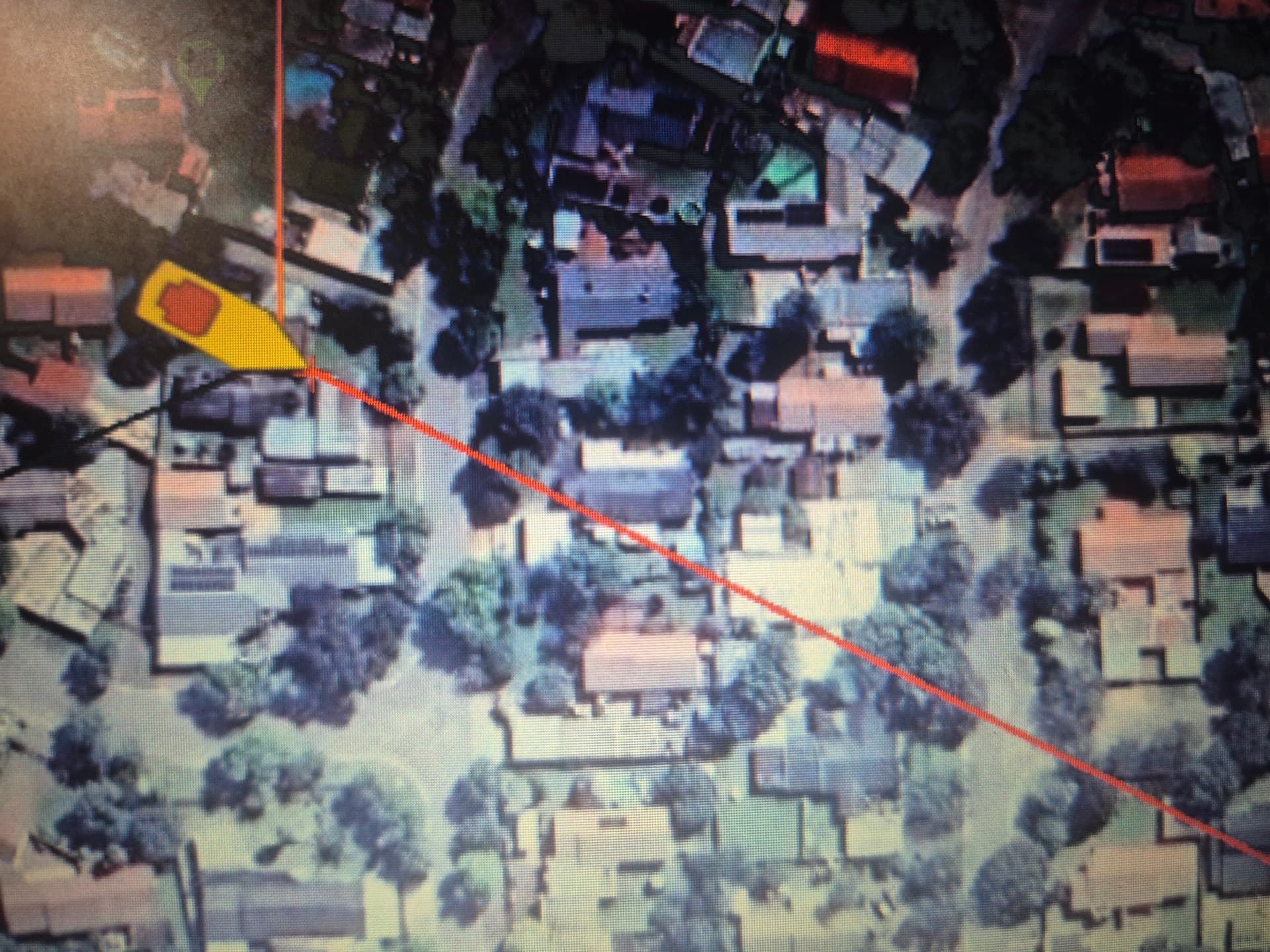

Good day,
I am having a serious problem getting my boat to go to waypoints or RTL. When I program a WP and set the boat to auto it seems like the controller does not know how to steer the boat. It turns too much, turns to the other side too much goes left turns, goes right makes circles etc. I neet to tune the behaviour but it seems like it is completely lost and dont know how to correct itself. Please advice on wich parameters to check and good settings to start at.
I am also thinking myframe type might be wrong. Currently set to 0 = undefined. Frame class is set to 2 so that should be fine.
The boat is driven by dc motor to propeller x1, servo is steering the boat / rudder.
Gps is on 17 sats. Steering from remote control is smooth without any problems.
Other settings I did but without much luck is:
ATC_STR_RAT = 120
ATC_STR_ACC_MAX = 90
ATC_STR_RAT_FF = 0.5
ATC_STR_RAT_P =0.8
ATC_STR_RAT_I = 0.2
ATC_STR_RAT_D = 0.03
Please advise.
My heading is facing straight inline with boat. Also compass calibration is done and in order.
