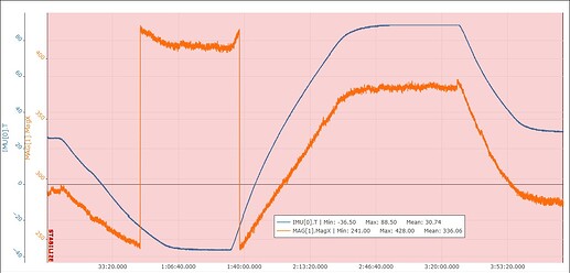

I observed that BMM350 mag value is offset at low temperatures.
When I deleted the following source code and run it, and the offset stopped.
I don’t think this code is necessary, what do you think?
Thank you for your cooperation.
Hi.
I got DataFlashLog in a low temperature environment.
Mag0 is IST8310.
Mag1 is BMM350.

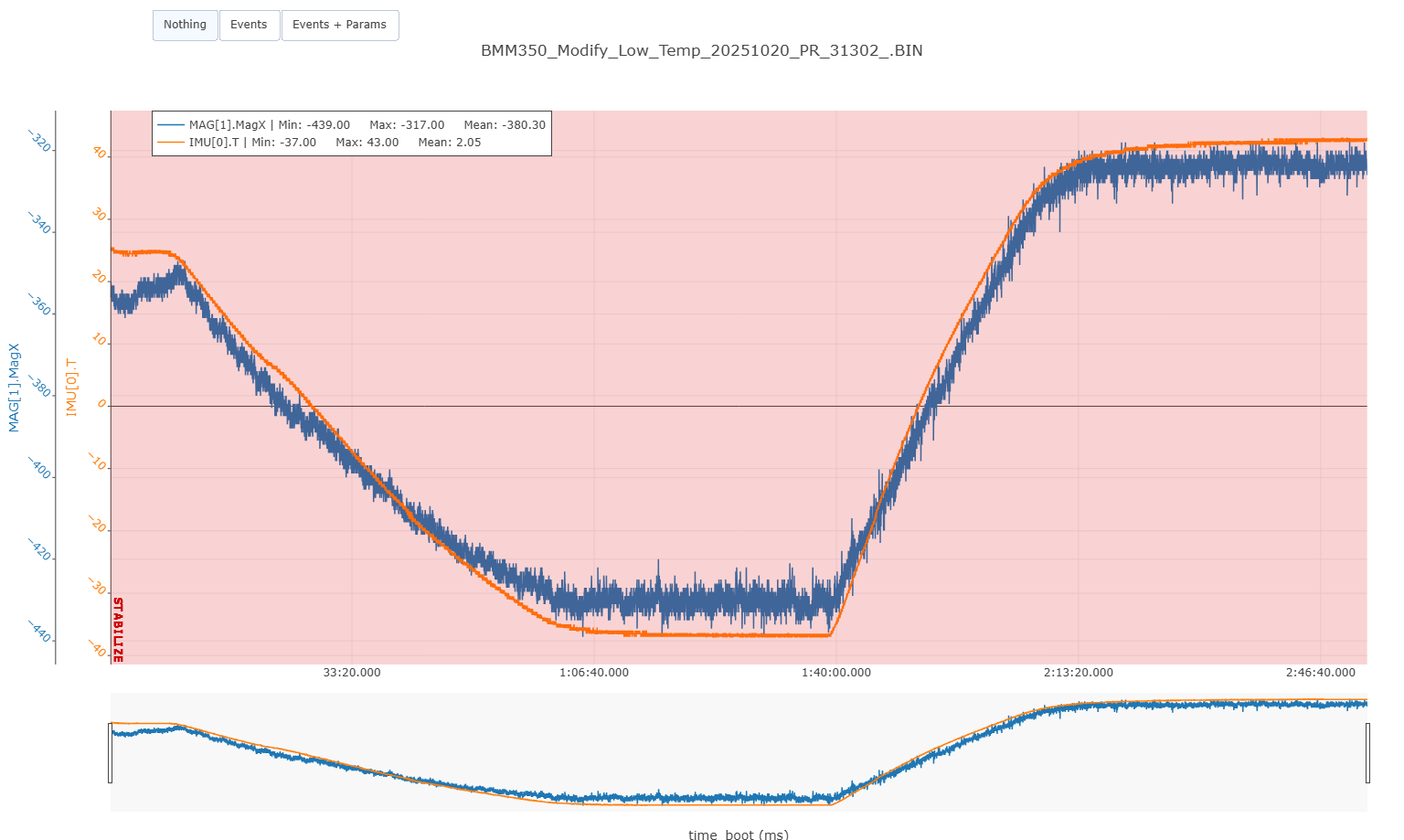

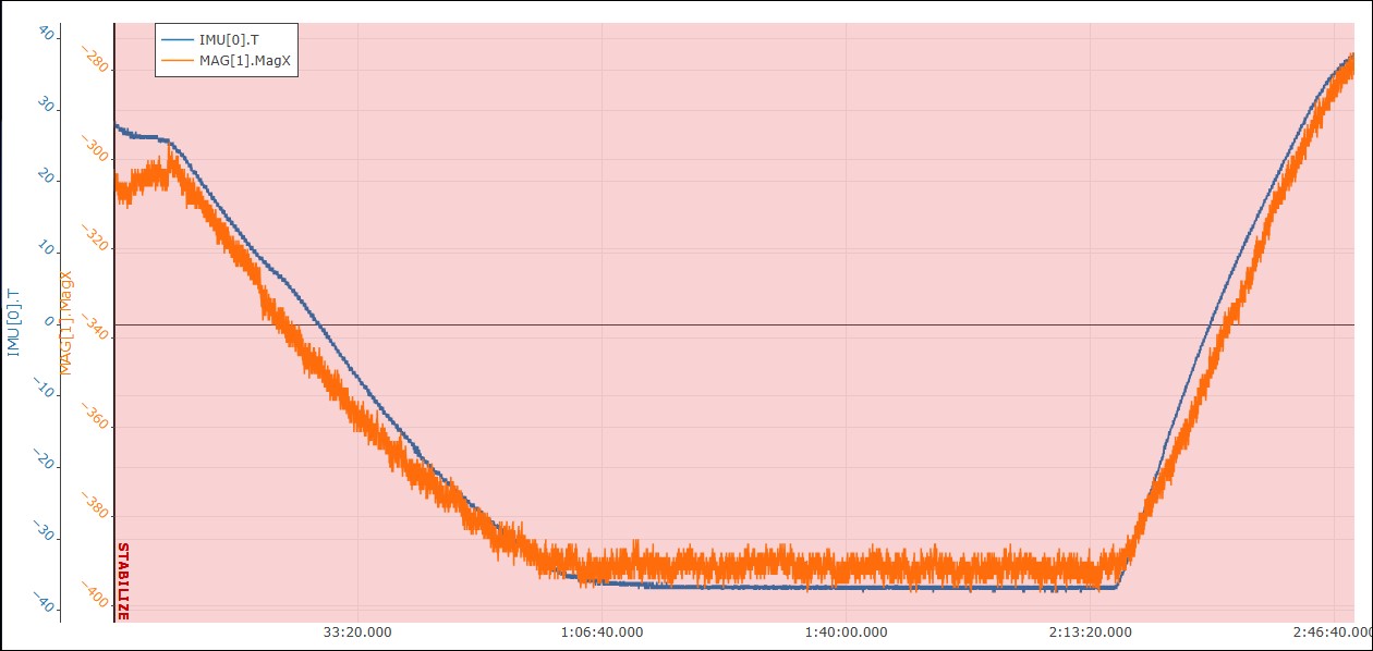

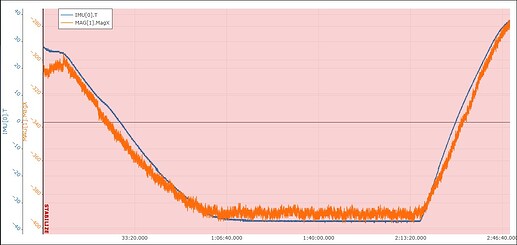

Hi @n-ito2222,
Thanks for the info. We have reproduced the issue and created a PR to fix it.
