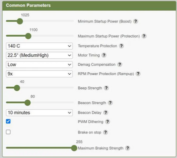

So a few days ago,I asked about the settings for BLHeli_S but now I have managed to finally flash Bluejay (I think 4.6.3 solved a passthrough bug that made three of my ESCs unrecognizable in 4.6.2)
I’m in the process of tuning a quad with 3s, 2212 1000 kv, 8045 props (will soon change to 9045). What settings should I use for maximum endurance? It is meant as a really slow flying drone.
Since most of the info on the internet is for small FPV quads, I would really appreciate if someone made a post on what to do on bigger quads and how exactly each setting affects performance.
Thanks!
For longer flight you can try 48khz and timing lowered to 15 degree or even less.
