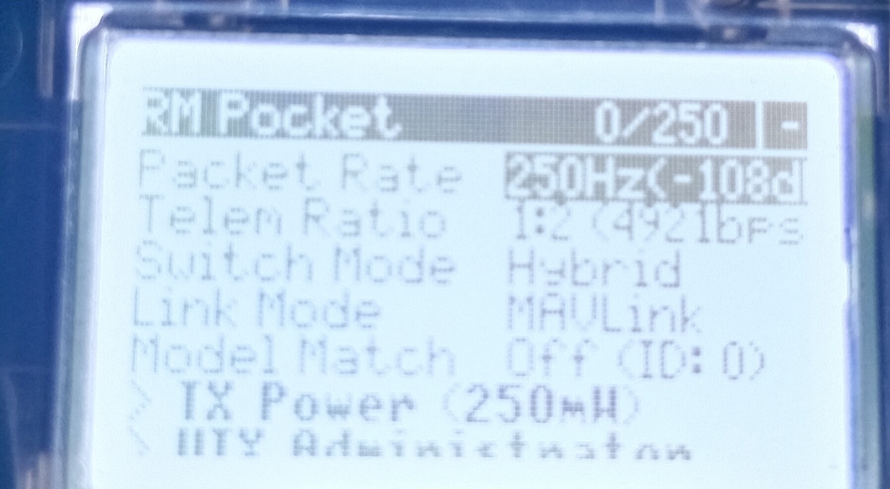

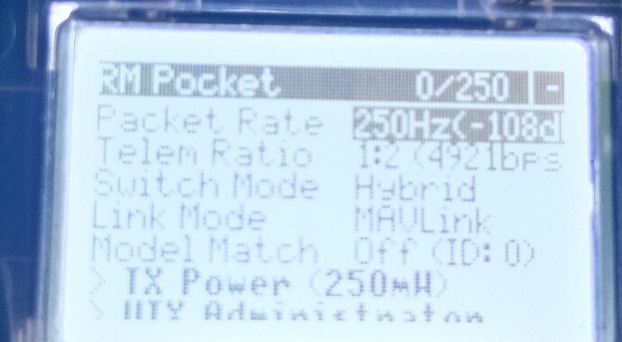

Best settings for mavlink using internal module
Like
Packet rate
Telem ratio
Switch mode etc for radiomaster pocket
Rate - as fast as you can take it without losing link stability
Telem Ratio - fixed at 1:2
Switch mode - Hybrid for most vehicles
DO NOT use Ch5 as Arm/Disarm switch, using any immediately disarming switch is strongly discouraged, (Arm)/Motor Emergency Stop should be used instead.
