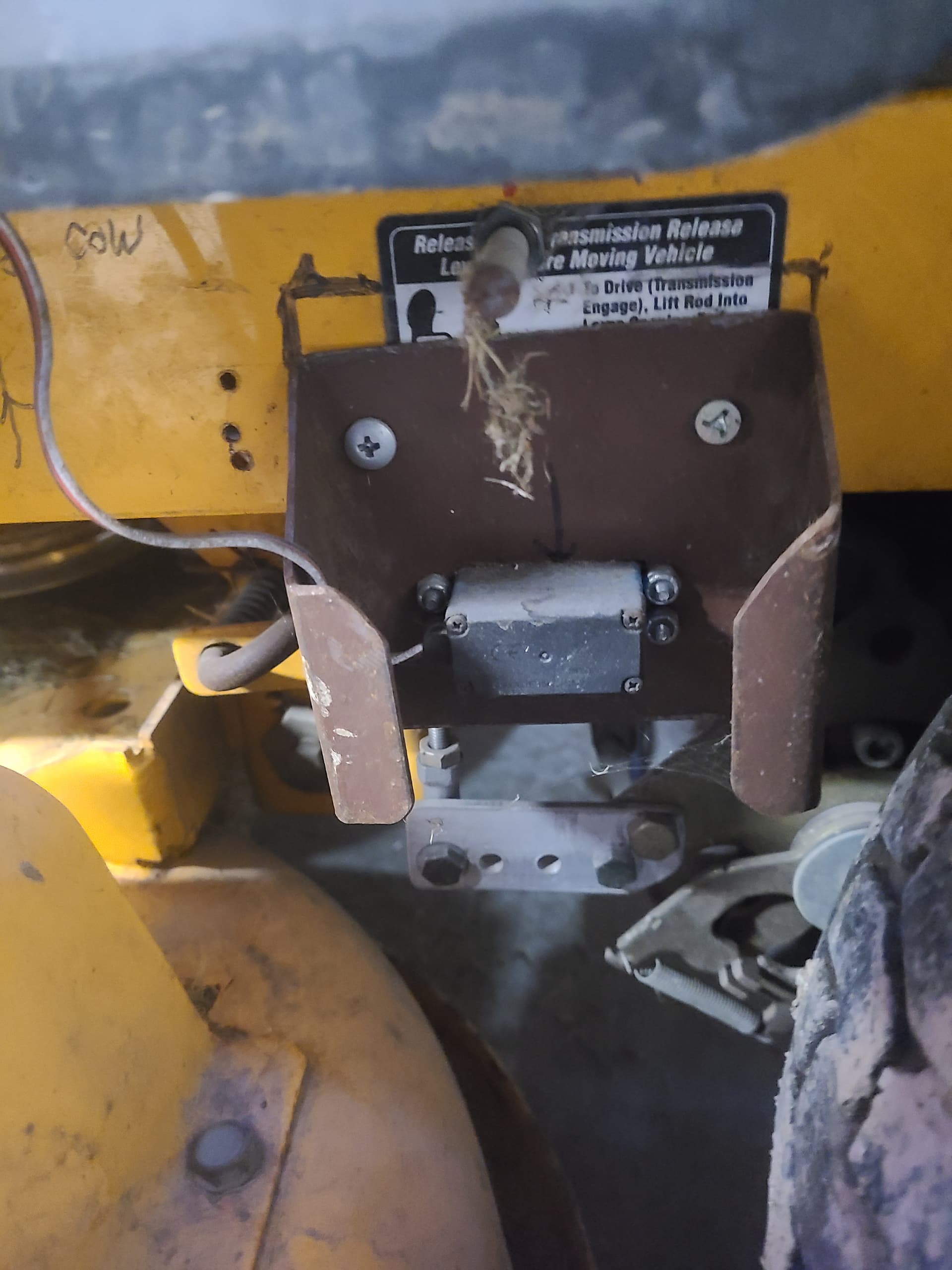

I try too read all the post and there is much discussion about Huge servo’s attached to hyd motors on zero turn mowers. I have (sense 2018) used 35g servos on my 60" Cub Cadet. The hyd motor only requires 16 g when eng off and 10g when eng running. I further reduce the pull to 5g running and 8 g eng off ,by adding a 2 inch lever (a mechanical advantage of about 2 too 1) to the existing hyd motor linkage. ( pic attached)
I also removed the steering levers and seat. (without that extra weigh and me I Mow 5 acres on 2 gals of fuel) .I have a adjustable pwr supply with volt and amp meter attached. The amp draw with servos engaged is less than 1.5 amps.
I use the tiny rc receivers attached to 20 amp dc relays to control blade on/off, set throttle to what ever speed I need mow at and let the governor kick in in high grass. highly recommend many ,many fail safes. I use radio control and mechanical switch’s. plus the mechanical parking brake on the cub(the hyd motor whines if something trying to input.) anyway I just want all to know the are cheaper ways out there.

Hey Rustey! You might consider removing the centering spring on the HydroGear drives on your mower. You don’t need it in this service and it just adds significant load to the servos.
FWIW, I have 700+ hrs on one mower with cheap no name servos. The HydroGear drives don’t need a HD servo. However, bigger servos, within reason, are almost always good idea. We are dealing with hobby grade components…. Good luck!
Thanks ,I’ve run my 35 Gram servos for 8 yrs. And the spring in the photo is a much smaller one just to insure hyds return to neutral.
You’re probably right ,it is not necessary.
