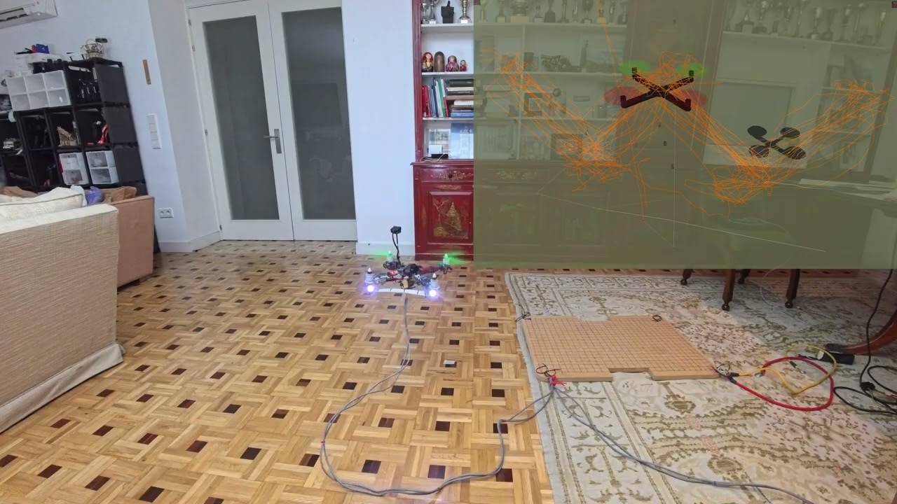

On this video :
VIDEO
the quad beeps when reaching the mission waypoints (vertexes of the ‘W’).
It is v4.6.3 on PixRacer R15.
I cannot locate parameters about beep when reaching waypoint , or how to do it.
It is a desired feature . How can I replicate it on other vehicles?

Here two types of buzzer are described: those requiring a waveform (moreless speakers), and those requiring a voltage level. On this other mission the FC buzzer requires a voltage level. The software takes care in not interrupting the program flow while sounds are produced.
So for above mission, in which the FC buzzer required a voltage level, since there was an on board camera, I transformed the mission video into .mp3, and filtered it around the buzzer tone (2700Hz) as follows:
ffmpeg -i mission21Audio.mp3 -af “bandpass=f=2700:width_type=h:width=50” mission21Audio_2700w50.mp3
obtaining:
The tone is seen at beginning (arming) and at the end (disarming) but not in between.
For a fast check I inserted code to force beep at waypoints at /ArduCopter/modeaudio.cpp:

executed a similar mission where apparently there were no beeps at waypoints, got the audio from the video mission and filtered it:
ffmpeg -i mission22Audio.mp3 -af “bandpass=f=2700:width_type=h:width=50” mission22Audio_2700w50.mp3
obtaining:
with the same tones at beginning (arming) and at the end (disarming), but also in between separated 2s.

Beeps were there (waypoints also separated 2s) but could not be heard by a normal ear, since propeller noise was much louder. So if including code for this case, it can be imposible to hear the beeps.
