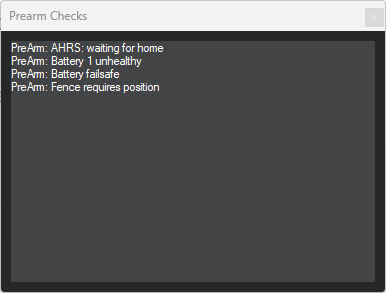

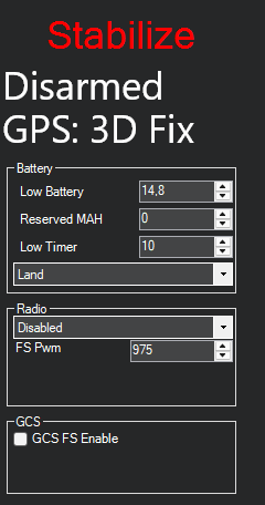

Hello, I have set the parameters of Battery monitor 1, the battery voltage is correct, and I have also set everything in the Initial Tune Parameters tab. But the warning is always on.
PreArm: Battery 1 unhealthy
PreArm: Battery failsafe

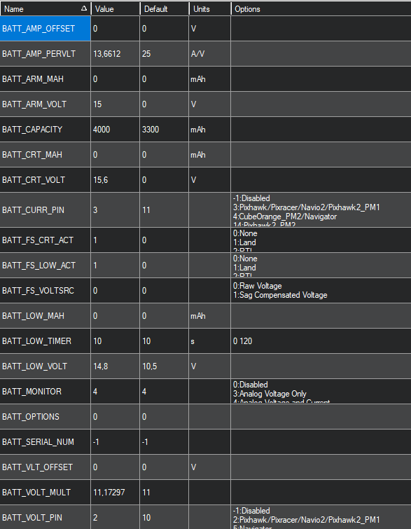

Please show also your PARAM file
This is only a picture of a part of your PARAMS. Please send a file with all PARAMS
Also show a log.bin file with LOG_DISARMED = 1 (enabled)
Your setting of BAT_CRT_VOLT = 15,6 is above the nominal value of a 4S LiIon Battery

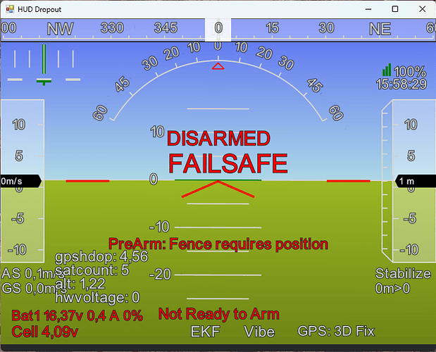

Here you have a file with all the parameters, there was only this log, I do not know if it is the one or not. I changed the critical voltage, thanks, but I couldn’t solve the problem with the battery.

Well, I didn’t say that everything was working correctly, on the contrary, for some reason I wasn’t guided by any manuals. Why? I don’t know. I answered the question about the wiki page, and wrote that I looked at it very inattentively. Which sensor do I use for current strength? I don’t know where to find information about this. I am using a full stack of SpeedyBeef405v4 & ESC 60A.
As a result, @dkemxr found my mistake, with the wrong pins, after the change everything worked.
