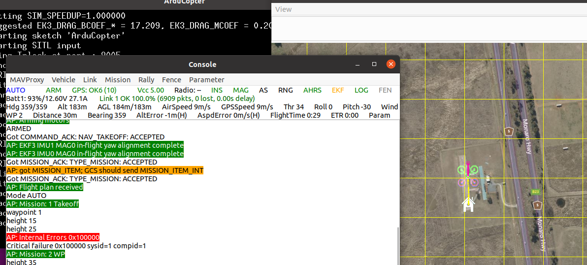

I’ve run into a really puzzling issue and would love to get your thoughts. I’m using pymavlink to send a batch of parameter-change commands to an ArduCopter running in SITL, and every so often the SITL console spits out this message:
AP: Internal Errors 0x100000
(see screenshot below).
I tried to dig in and figure out what’s going on, but as soon as I cut down on the number of parameters I’m setting in one go, the error vanishes completely. Has anyone else ever seen this? Do you know what might be causing it?
For reference, I’m running AP: ArduCopter V4.7.0-dev.

There is a limit on the number of parameters that can be set. It has to do with the way the parameter memory is managed.
Thanks! Could you please let me know where this limit is defined? I’d like to find out the maximum number of parameters that can be changed in a single batch—it would be really helpful. Also, this issue feels like a “ghost,” since sometimes it’s triggered and other times it isn’t.
I do not know exactly where the limit is, nor where it is defined.
Maybe another dev could chime in?
