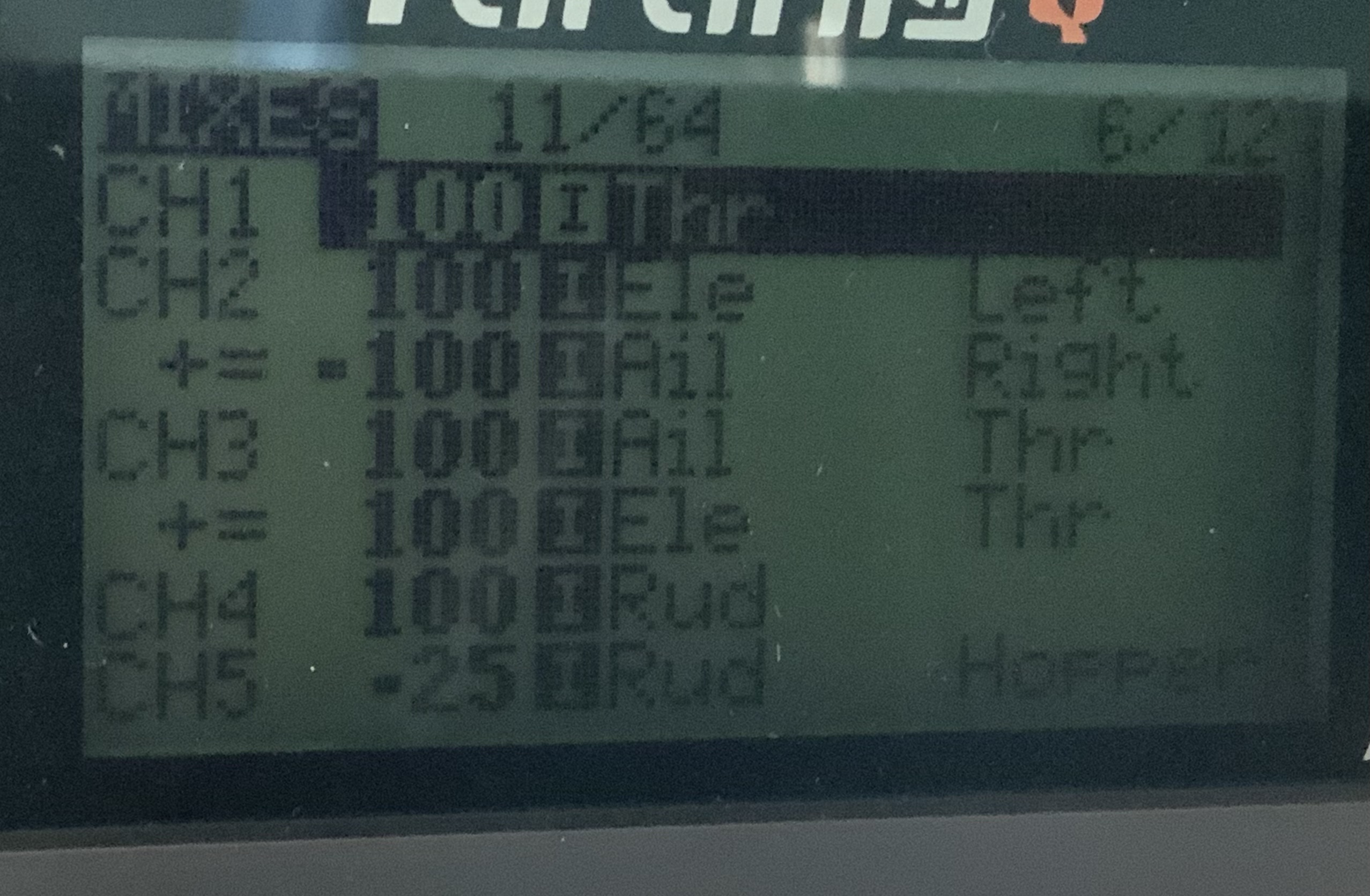

On the taranis this is achieved with a mix which allows control of the pumps based on a single stick input and it works. See screenshot. The mix is on channel 2 and t3 in this case
Problem is I do not know how to implement this mix with the pixhawk.

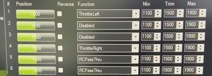

I tried this setup and here’s the outcome.
Servo output 1 set to throttle left
Servo output 2 disabled
Servo output 3 disabled
Servo output 4 set to throttle right.
If I push the left hand stick up both forward engines run
If I push it down both forward engines stop
But here’s now the interesting thing
If I push the right hand stick up then it operates the left reverse and right forward pumps to steer left
If I push it down it operates the right and left forward pump to steer right.
This is exactly what I am trying to achieve but I was trying to do it on one stick. But I can cope with that.
Question now is what will it do on a mission, will it steer as steering is on the right stick and these servos are disabled in the servo output or will it just go forward based on the left stick operation?

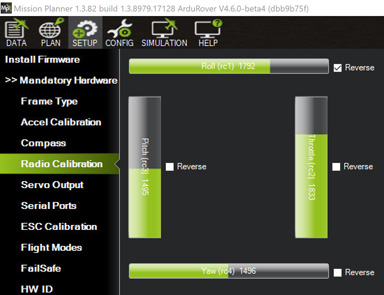

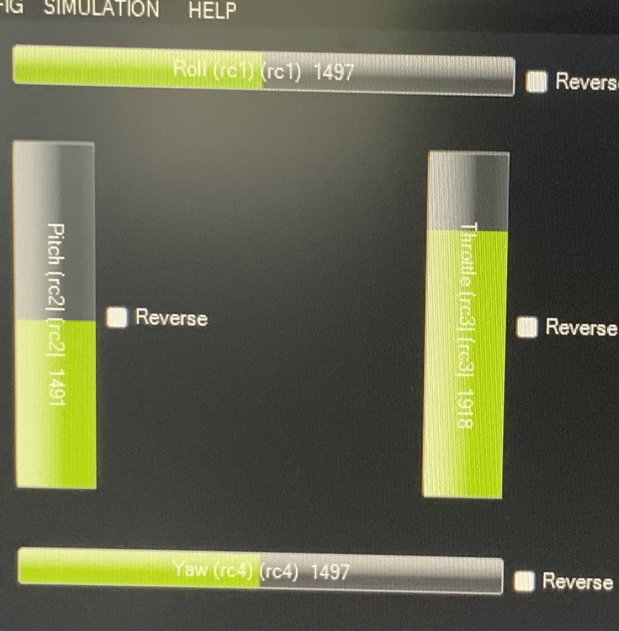

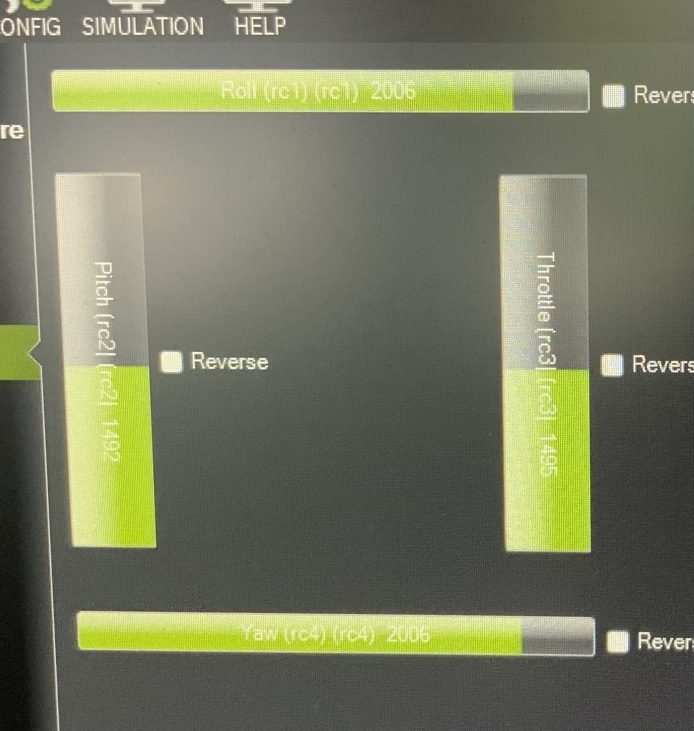

Which stick do you want to use? Mode 2 radio? For Rover Throttle is Throttle and Steering is Roll. Use the RCMAP parameters to assign how you want to control it.
This is showing Throttle forward and a Right turn. Pitch and Yaw do nothing.
My radio is mode 2
The left throttle input on the transmitter is roll and yaw together in the radio calibration screen but is operating the forward and reverse pumps correctly.
The right elevator input on the transmitter is operating throttle in the radio calibration screen but is operating front and reverse pumps correctly for steering
This is my servo output configuration
Essentially the sticks work albeit a little mixed up.
Do you have a mix on the radio? If so get rid of it. Then, using the Radio Calibration screen for reference configure the RCMAP until the left stick throttle moves the throttle bar only and the left stick yaw (left/right) moves the Roll bar only. The right stick should do nothing to drive the craft if configured this way. It’s the most common configuration. Well, you could configure the Right Stick instead if you wanted to for some reason, up to you.
