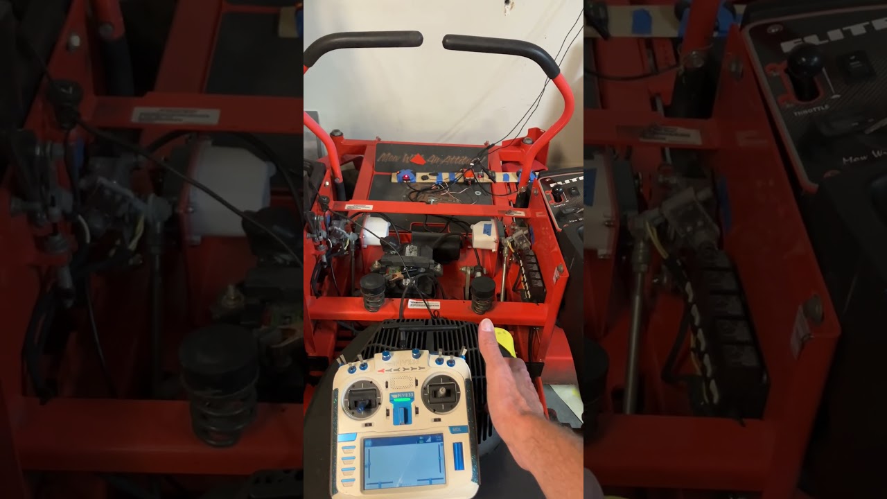

Lesson learned: My servos are sporadic in response. Sometimes they are quick and move as expected. Sometimes they take more time to return to center (or other position) but do so in smaller uneven steps. See video below.
The problem was testing with a lower amp wall power supply for the bench test. After changing to a more powerful power supply the problem is gone. Obviously long term, the boost converter will be wired to the battery.

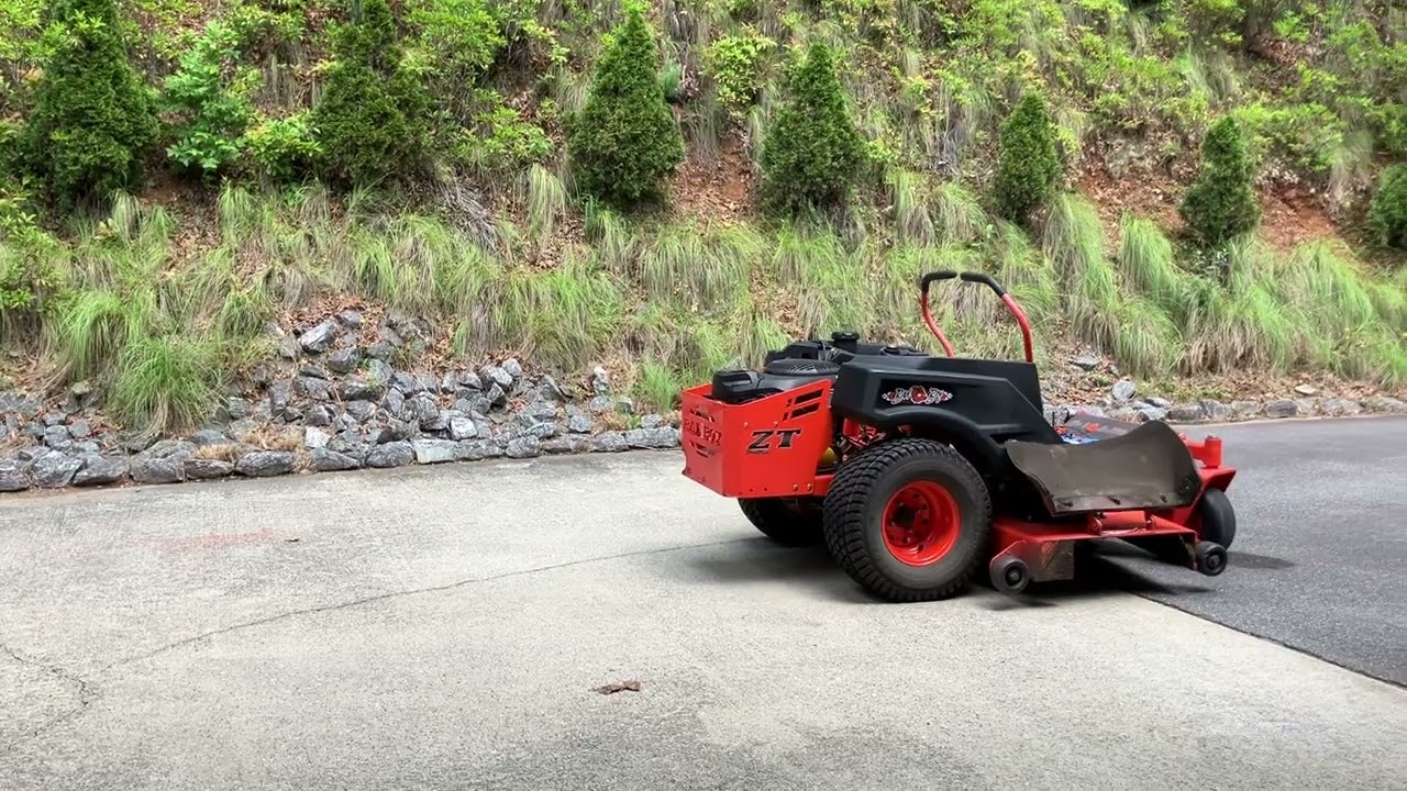

Test run in manual mode
