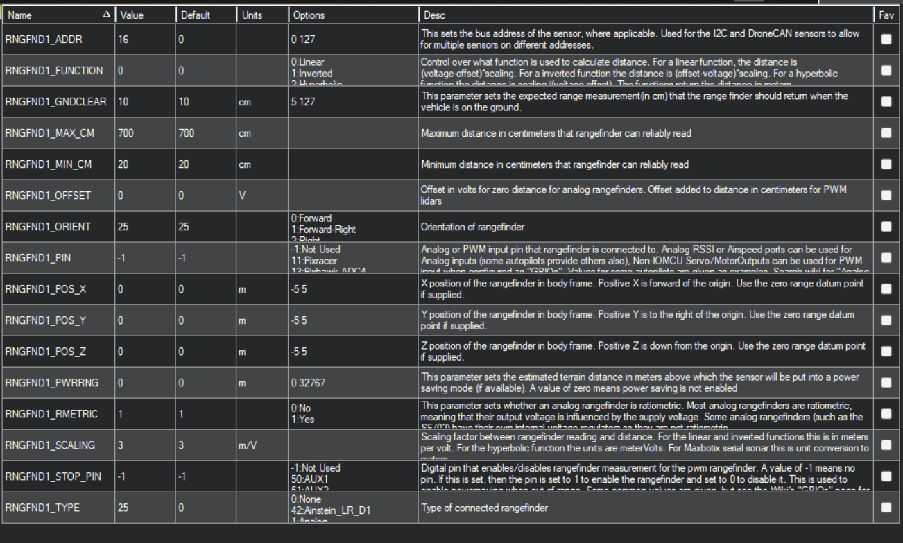

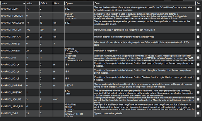

I am using the same setup 5 Benewake TFmini plus with Ardupilot but it is showing Rangefinder
x’:No data sometimes it works but randomly it is showing this error.
Could you share a picture? Thank you
