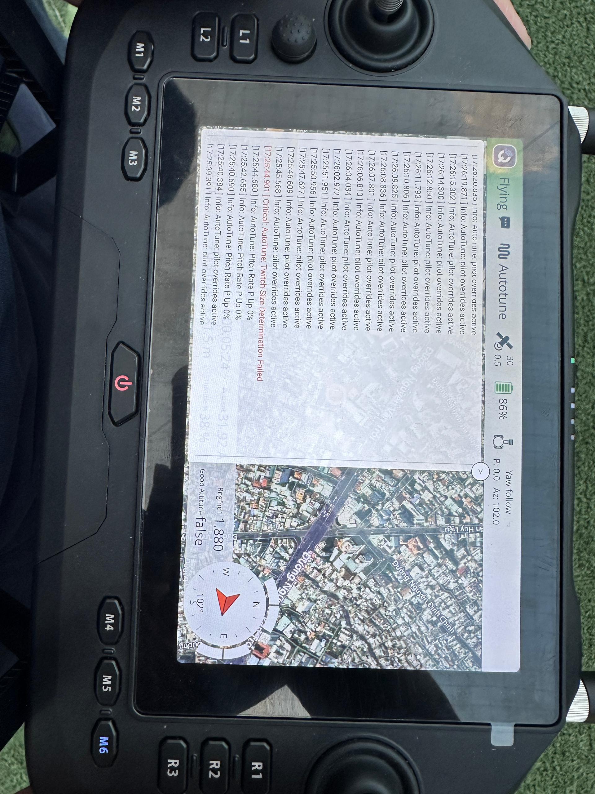

Thanks Lucas! Yesterday I have an Autotune and this happen, what does that mean: Twitch size Determination Failed
It means that your tuning preceeding the autotune could be improved. Probably the notch filter is not good enough.
I’m guessing you did not use ArduPilot methodic configurator software to tune it, right?
