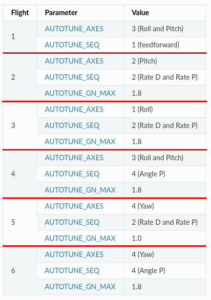

I’d like to try AutoTune soon.
The documentation includes a table with recommended flight settings.
https://ardupilot.org/copter/docs/traditional-helicopter-autotune.html#autotune-flights
I don’t understand the following:
Should AUTOTUNE_AXES be set to 3 or 2?
What value should AUTOTUNE_AXES have?
AUTOTUNE_AXES is a bitmask. On a Heli, you add up the following values:
  • 1 for roll
  • 2 for pitch
  • 4 for yaw
That is, if you want to tune both roll and pitch in a single flight, you add 1 and 2, which makes 3.
In your screenshot, there are two flights, the first wants both roll and pitch to be tuned (hence 3), the second wants to only re-tune pitch (hence 2).

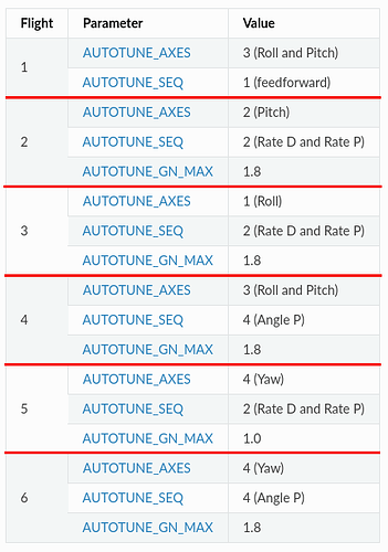

I’m sorry, but I don’t understand.
Flight 1: AUTOTUNE_AXES can be 2 or 3, but not both.
Flight 6: No value is specified for AUTOTUNE_AXES.
There is a thin line after AUTOTUNE_SEQ for Flight 1 on your screenshot. The next AUTOTUNE_AXES is for Flight 2. Here are the partitions, where I enhance the existing horizontal lines in red color:
This should also resolve your doubts about Flight 6.
Ah, now I understand the table.
Without the red lines it is difficult to read (at least for me).
Thank you very much!

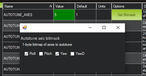

What are you using for GCS? If you use mission planner you can just click bitmask and select what you want. Its presented a little simpler that way.
I use Mission Planner.
My problem was that I didn’t correctly identify the boundaries
between flights in the table.
