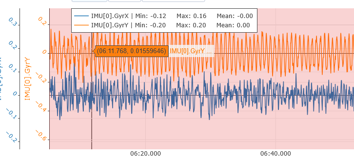

My drone without camera is about 750g. With camera it’s about 1200g.
Without camera I can do (and I already did) autotune - it worked fine.
With my camera the drone oscillates, so I would like to perform another autotune - but my battery drains before autotune algorithm would finish the tuning process.

You have strong not filtered vibration at 51 hz, it’s on Y axis only (roll), please address that. It will affect your autotune. Than you can setup your RPM notch something like this.
edit: y is roll axis
This vibration shall be solved via hardware, with changing the camera mount, right?
Yes, software filtering won’t be effective on such small frame size.

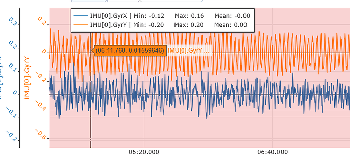

Y̶ ̶i̶s̶ ̶r̶o̶l̶l̶ ̶a̶x̶i̶s̶,̶ ̶c̶h̶e̶c̶k̶ ̶y̶o̶u̶r̶ ̶c̶a̶m̶e̶r̶a̶ ̶m̶o̶v̶e̶m̶e̶n̶t̶ ̶l̶e̶f̶t̶-̶r̶i̶g̶h̶t̶.̶
̶I̶t̶’̶s̶ ̶c̶l̶e̶a̶r̶l̶y̶ ̶v̶i̶s̶i̶b̶l̶e̶ ̶t̶h̶a̶t̶ ̶r̶o̶l̶l̶ ̶a̶t̶t̶i̶t̶u̶d̶e̶ ̶c̶o̶n̶t̶r̶o̶l̶ ̶i̶s̶ ̶m̶u̶c̶h̶ ̶n̶o̶i̶s̶i̶e̶r̶.̶ ̶
Correction - that’s not noise, it’s oscillations.
seen here

I was wrong about axes correspondence, the correct is:
Body axes (X, Y, Z):
+X points forward (out the nose).
+Y points to the right.
+Z points down (toward the Earth).
Roll = rotation about X (Positive roll → right side goes down)
Pitch = rotation about Y (Positive pitch → nose goes up)
Yaw = rotation about Z (Positive yaw → nose turns right (clockwise when viewed from above))
You have clear 2hz oscillations on pitch axes, not roll as I mentioned before, fixing that 51hz vibration might fix it
