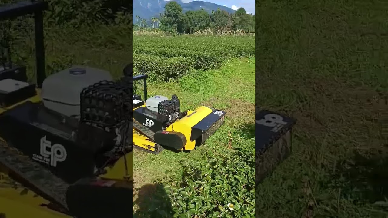

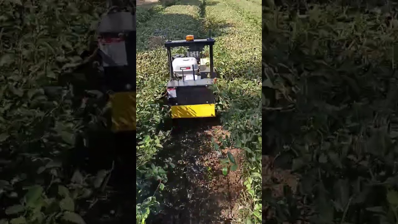

Autonomous Mowing in Tea Plantations using ArduPilot Rover + RTK Fixed (Field Experience)
I’d like to share some field experience deploying an autonomous mowing rover in a tea plantation using ArduPilot Rover with RTK Fixed positioning.
Tea plantations present a fairly structured environment (consistent row spacing, repeated paths), but manual mowing is still labor-intensive and often inconsistent, especially on slopes.
With a local RTK base (Fixed mode), we’re seeing very stable centimeter-level positioning and strong path repeatability in real operation.
Some observations from testing:
  • Repeatable trajectories
    Missions can be re-run on different days with minimal deviation
  • Good crop protection
    The rover stays within defined boundaries and avoids contacting the plants
  • Works well in sloped terrain
    With proper tuning, tracking remains stable even on uneven ground
  • Suitable for repetitive field tasks
    Mowing is just one example — the same setup should apply to spraying or inspection
From our experience, for agricultural use cases, repeatability (relative accuracy) is often more important than absolute global accuracy. A fixed RTK base provides consistent results for this type of workflow.
