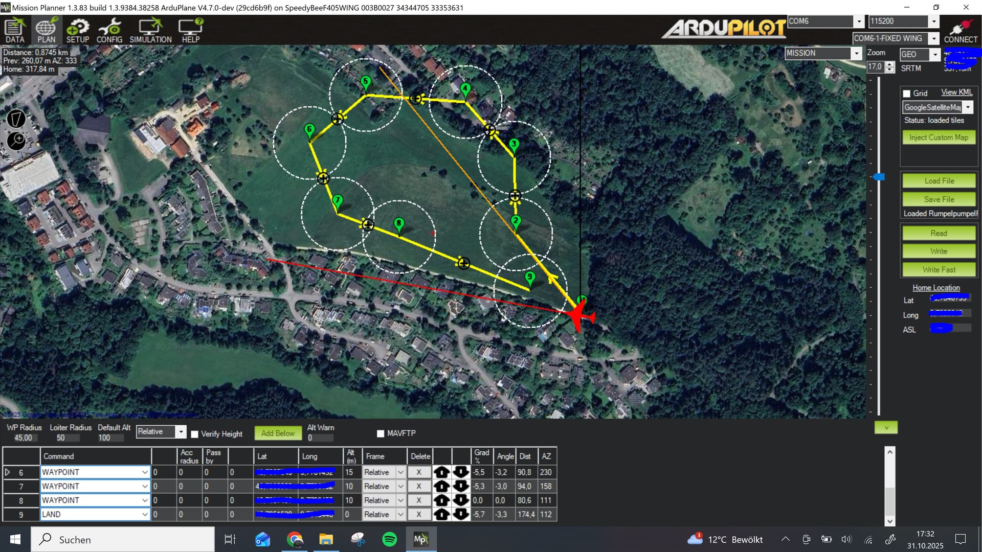

I flashed firmware 4.7.0 today. Everything is set to default as discussed (EKF is default, etc.). It’s best to look at the attached parameters. I’m slowly getting really desperate. It can’t be that difficult to integrate a LiDAR sensor and use it to plan an approach.
I have used different LAND_FLARE_ALT values. None of them really showed any change. I repeated the flight several times without making any changes, and each time it was at a different altitude, not by much but noticeable.
I believe that my LiDAR is not integrated into the approach. It works perfectly, the distances are correct in the DATA tab dialog box. However, I have never gotten a “BAD LiDAR Health” as a pre arm fail while my compass is complaining the whole time.
So could it be that it just wasn’t integrated properly? Or am I doing something wrong in the mission planning?

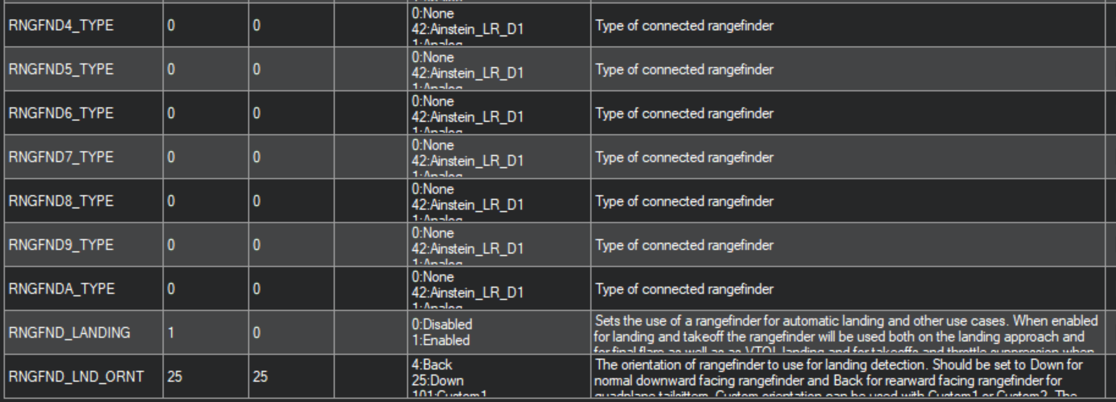

So you enabled RNGFND_LANDING = 1 and then you have set:
TECS_LAND_THR = 20% less than Trim cruise throtle
LAND_FLARE_ALT = 2
LAND_FLARE_SEC = 2’’ for a 3.3d slope as your mission (actual is 2.9 without flare)
LAND_FLARE_AIM = Begin with 50
TECS_LAND_ARSPD = 12 or your prefered land speed (1.3x STALL speed is ok)

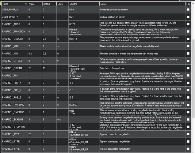

Yes, RNGFND_LANDING = 1 is there. But how can i check if the Rangefinder is working? As i said, there is no preArm fail with “Bad LiDAR health”. The only point is that RNGFND1 shows me a distance value in Data.
No, I haven’t tuned the Tecs parameters in detail yet. I’m using the default values for these parameters. I still need to set up the log. Would you be able to see right away if the LiDAR is working?

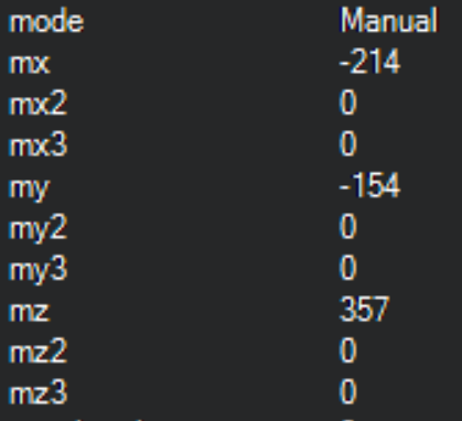

I have another question about my compass. Why do I keep getting the “Bad Compass Health” message?
I have calibrated the compass (several times) and it is installed at a sufficient distance from interfering objects. The supply line is even shielded. The FC is permanently installed in the aircraft with the compass. Why do I keep getting this message?
Are you sure about interference and compass orientation setting (some GPS units gave rotated compass)? Though IIRC with bad orientation EKF would be throwing a fit during flight.
Check for interference and orientation using Mag Fit.

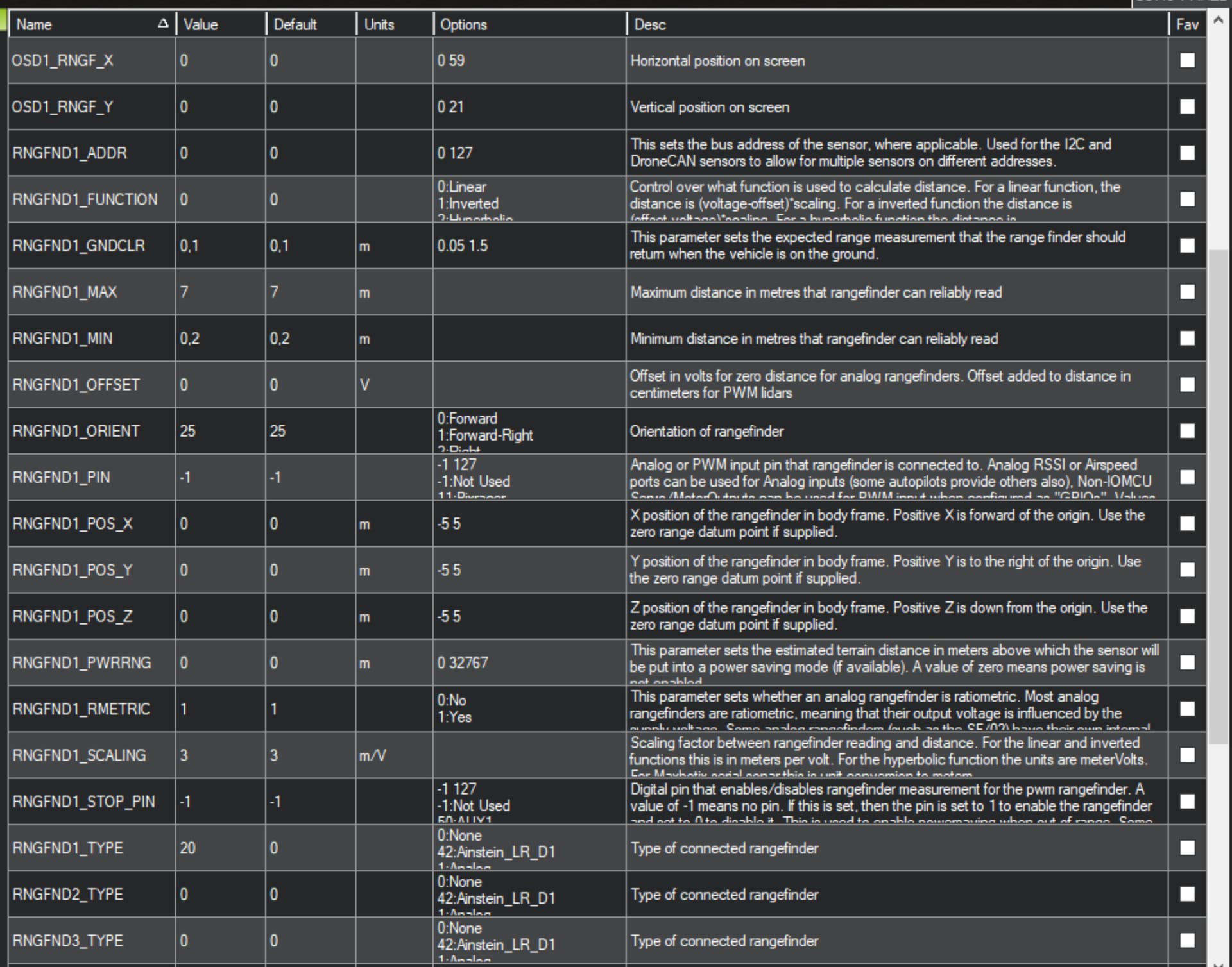

I have now performed an autotune flight and recorded a log. I can see that the rangefinder has recorded something and is therefore technically working. I compared the barometric altitude and the GPS altitude. The barometric altitude peaks slightly. The GPS speed and airspeed sensor give better results.
Is there anything else of interest that can be deduced from the log? Is it already possible to say whether the rangefinder will work during autoland?

The missionPlanner logAnalyser said that my compass isnt that good.. And yes the orientation is fine. I use the Matek M10Q5883.
Wow that is either a defective sensor or really bad electromagnetic interference. Check the log using the tool I linked.
