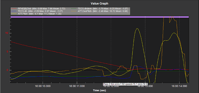

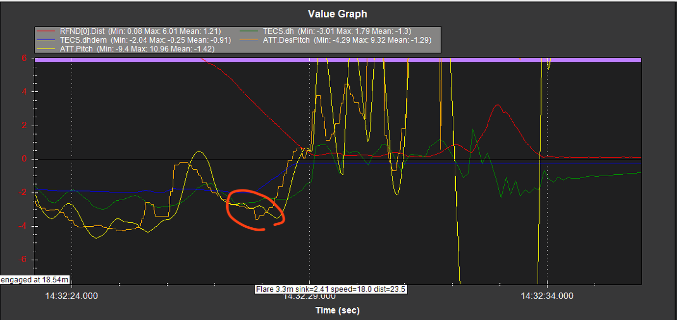

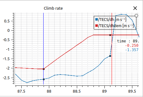

I attempt to use automatic landing, but there was a obviously hard touch down, after check the log, I found the aircraft didn’t establish the pitch angle during flare phase, causing touch down with a very high descent rate.
BTW, I used rangefinder to achieve more accurate altitude control
aircraft start to flare at 2m in log
“2026-01-31 16:00:11.755 Flare 2.0m sink=1.92 speed=15.1 dist=18.9“
so we could see when the vehicle start to flare, TECS.dhdem start to reduce but very slow, meanwhile, TECS.dh still keep as before even touch down.
and I also found when the flare start, the ATT.DesPitch jump down at the same time, could anyone explain what happened ?
log attached for your reference

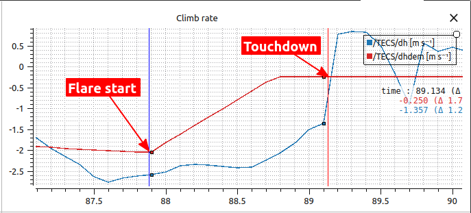

Within the time between the start of the flare and the touchdown, the demanded sink rate has had time to rise to 0m/s.
But only just! The actual sink rate didn’t have time to catch up. This is in part related to the inherent delay of the actual pitch angle to track the pitch angle demand.
I recommend that you pull your flare start a little earlier, by a second or two, and adjust to whatever that means for the flare altitude.

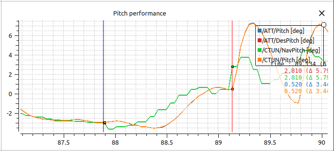

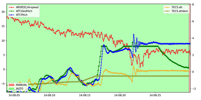

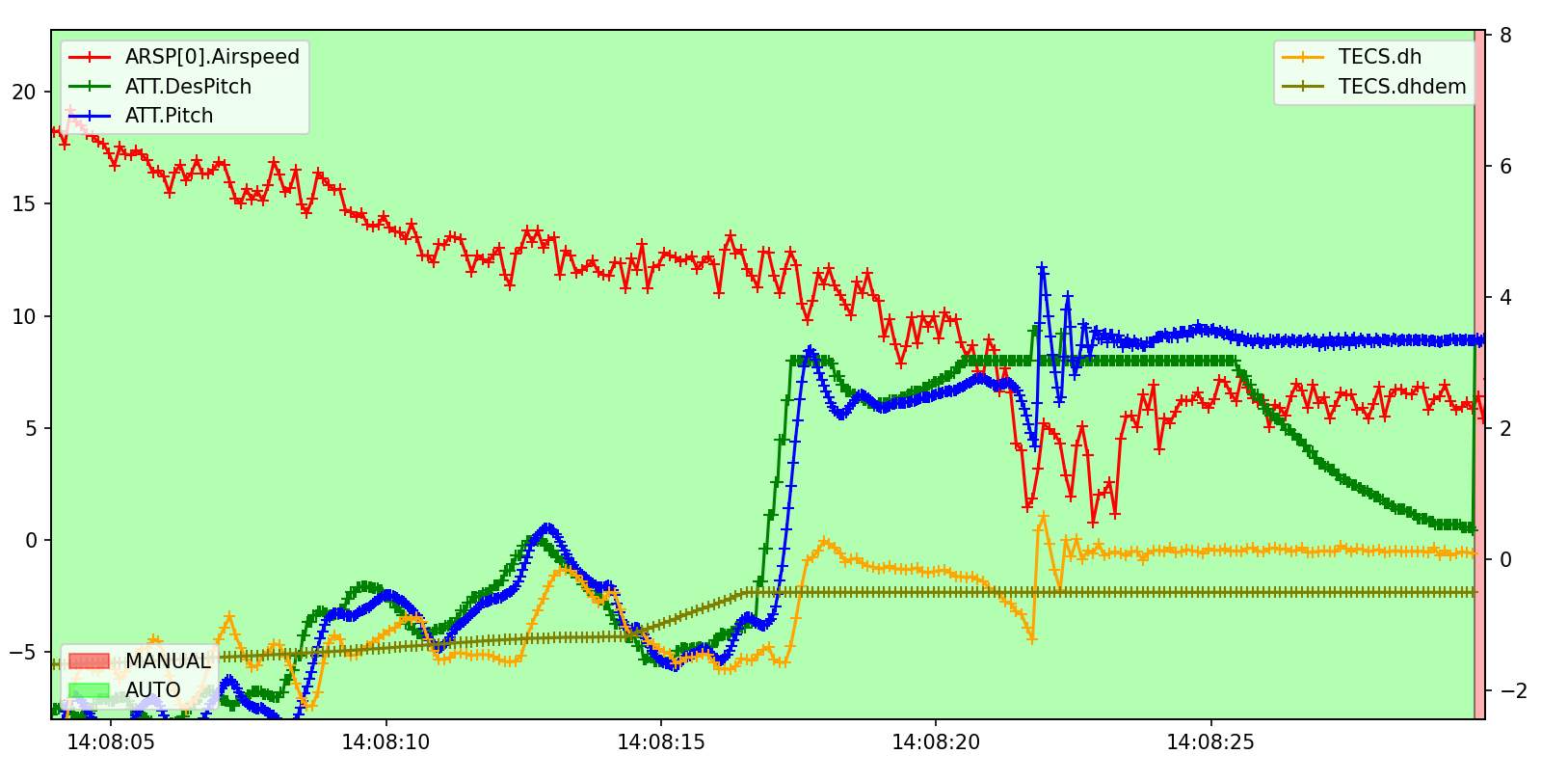

I think that plot you are showing is from your first log, where the TECS landing patch was not present (log 92).
In log 94 (with patch), this is the behaviour of the pitch demand:
The moment the vehicle enters the flaring phase, the pitch demand only rises.

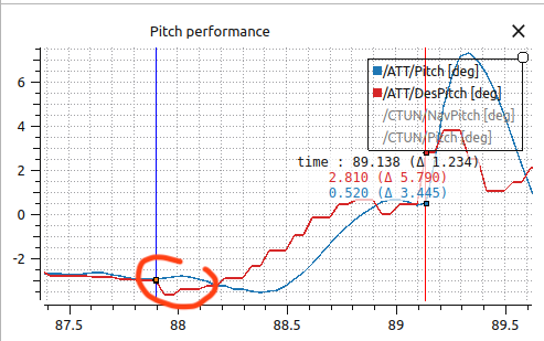

Hi @Georacer

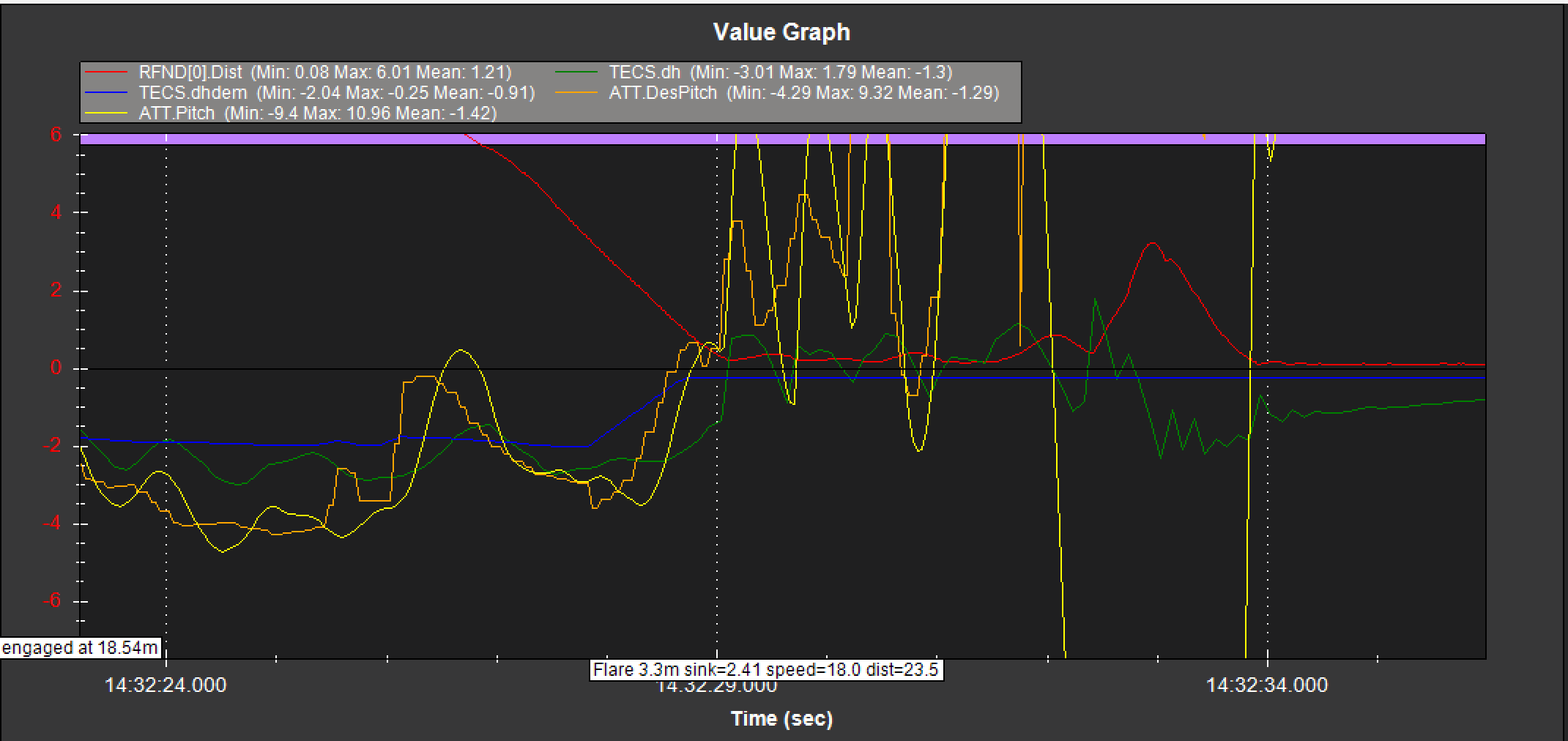

unfortunately, the DesPitch falls down also happened in log 94 in your screenshot
and I also recheck the log 94,
around 14:32:27.839 Flare 3.3m sink=2.41 speed=18.0 dist=23.5
you can see a noticeable drop in DesPitch, followed by a rapid decrease in Pitch and then a gradual rise.

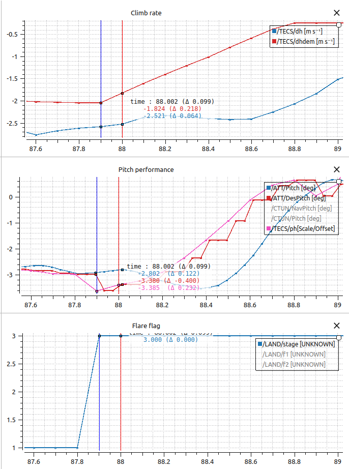

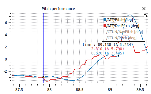

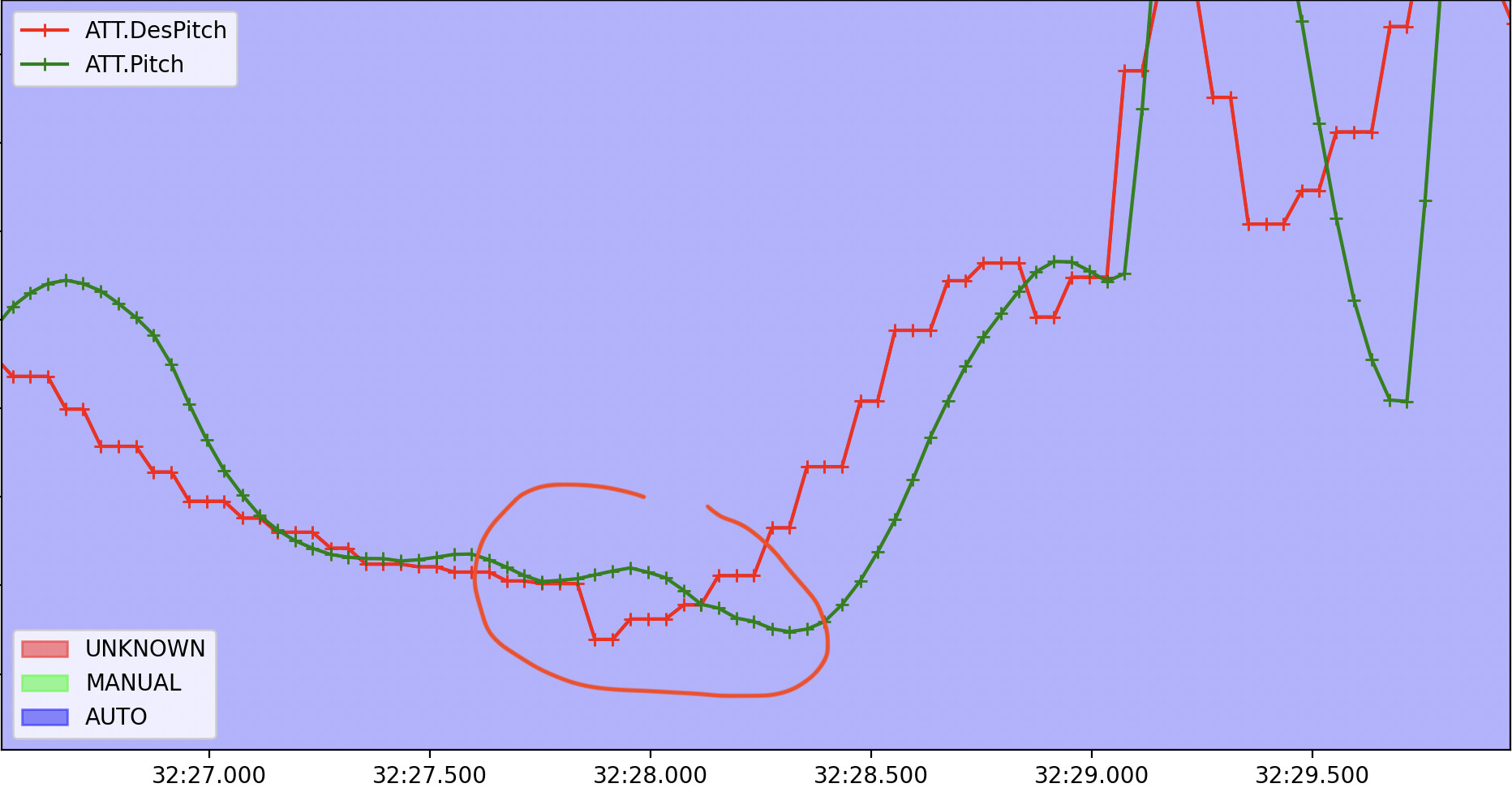

I think you were simply unlucky with this one.
Here is a plot with the TECS pitch demand, the attitude control pitch demand (downstream from TECS) and the actual pitch.
Notice that TECS had already started the pitch-down before the flare (blue cursor). And immediately starts increasing the pitch demand after the flare starts (red cursor).
But during that time, the attitude control loop has ran (or at least logged) twice, propagating that low pitch demand.
All of this happens in less than 100ms. And indeed the update rate of the TECS controller is 10Hz. The attitude control loop rate is 50Hz. So you couldn’t get a faster response in any circumstance.
Raising the flare height is the correct option here, you are operating too close to the limit.

I try to retest the flare today with higer flare altitude (LAND_FLARE_ALT = 4) and it work, noticeable flare maneuver was observed with smoothly touch down.
we also use the flap to achieve a lower touch down speed (TECS_LAND_ARSPD=12)
from the log, you could see the TECS.dh quickly raise up almost close to 0 and then a bit stall I think, but anyway, your are right, it’s work.
