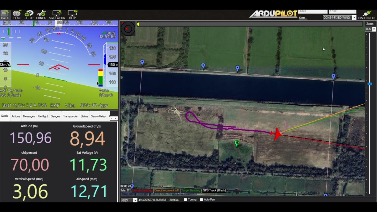

I’ve encountered another altitude descent issue during the autoland sequence
The glider gets stuck in loiter at a fixed altitude
I’m currently using version 4.7 Beta, but this had already happened with version 4.7 Dev in June 2025 (with a different glider and a different flight controller)
The glider is a motor glider fitted with an airspeed sensor and with soaring mode enabled
Most of the time, it works perfectly. There may occasionally be a conflict between soaring functionality and autoland mode…
Here is today’s log:
And last year’s log with a Mission Planner screen video:
