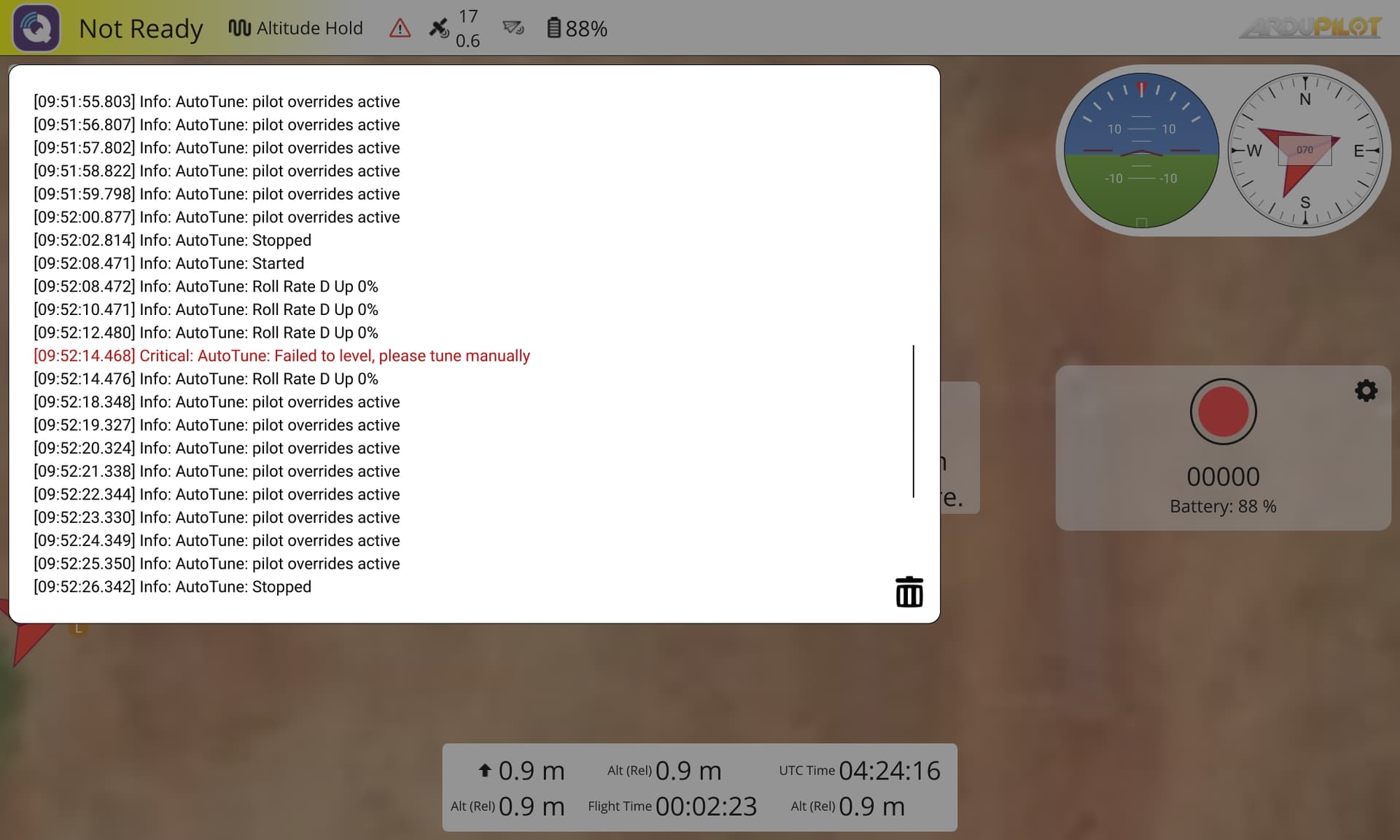

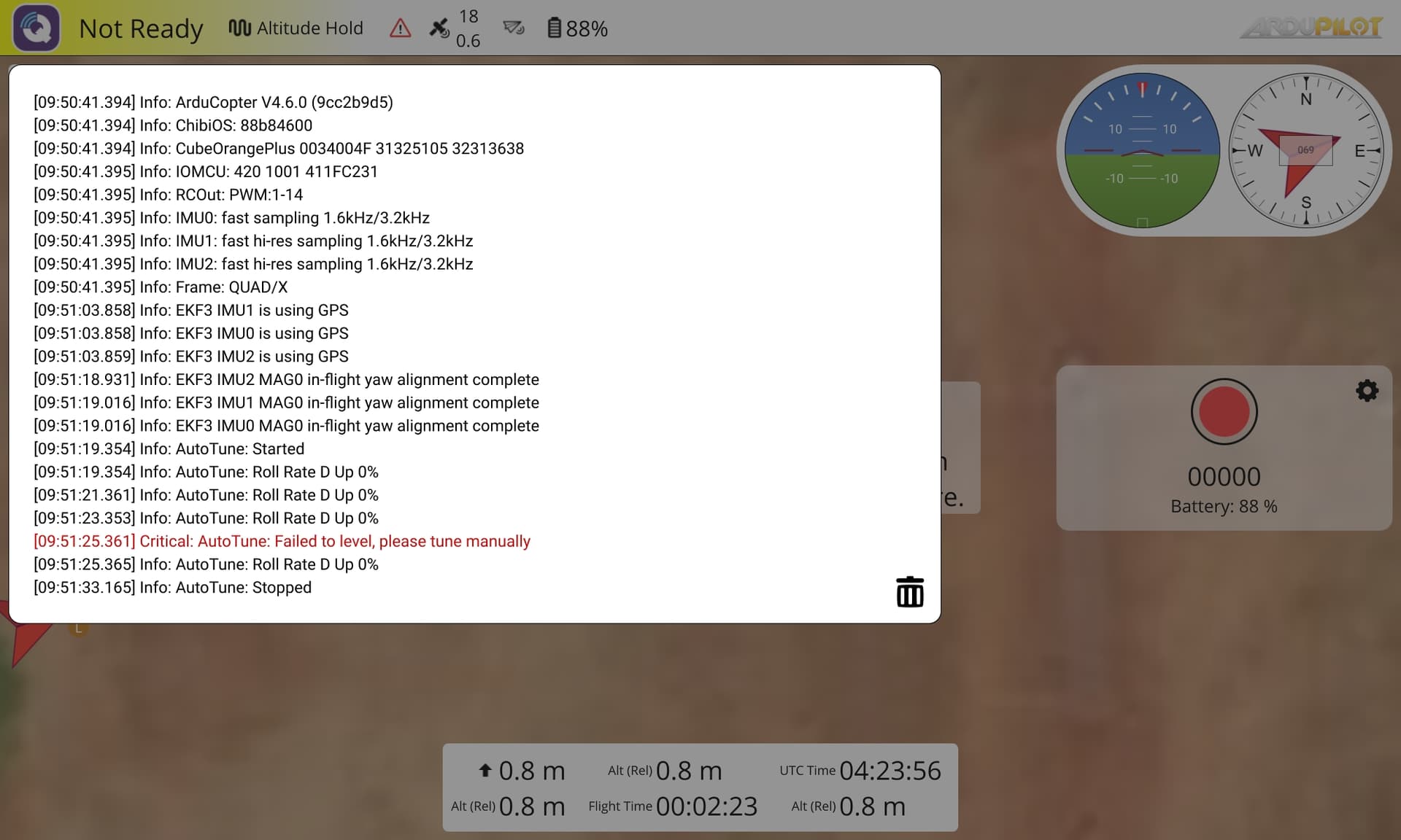

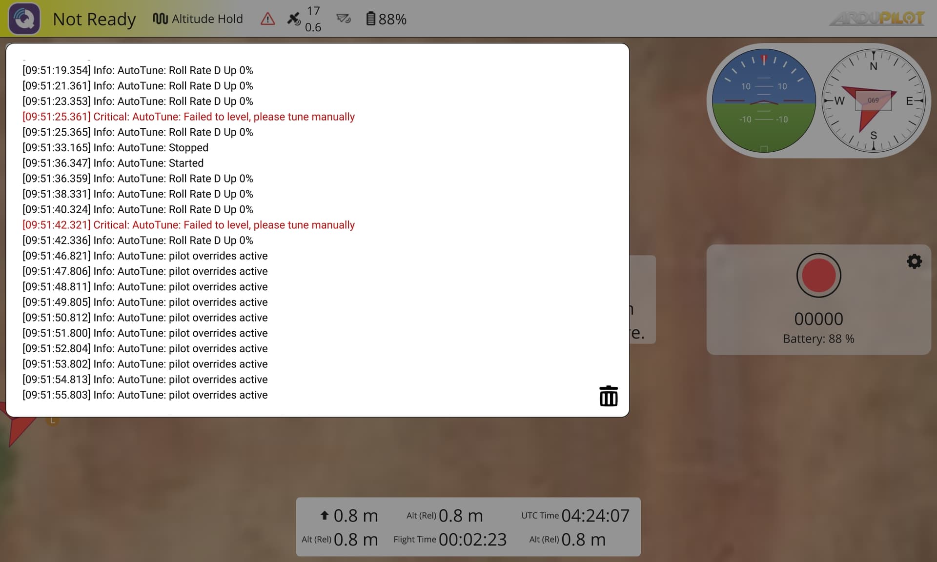

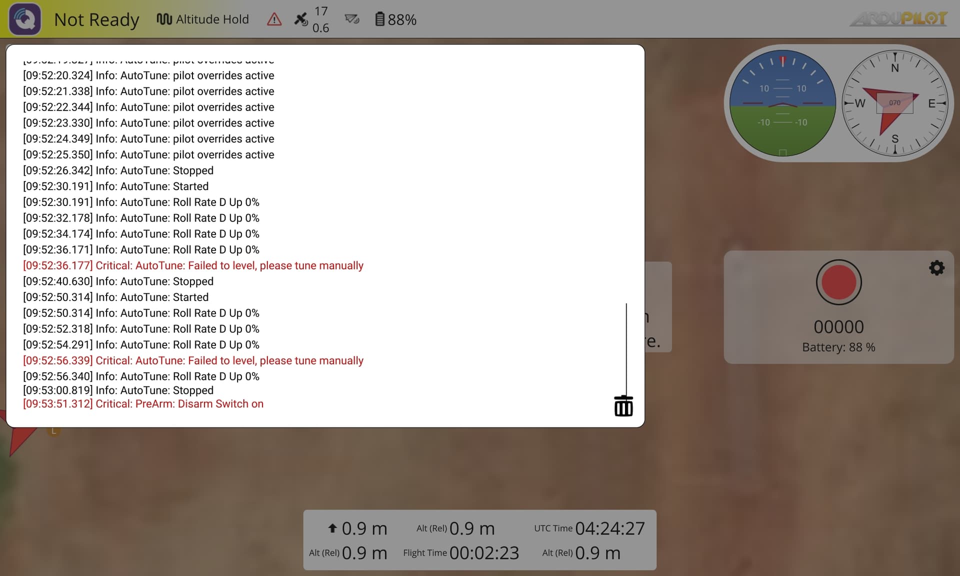

Hello Guys I’m trying to Do Auto Tune but it’s failing when ever I initiate. Ever time i started from AltHold mode only. Then I initiated AutoTune. But after some times it is telling that “AutoTune unable to level do manual tune”.

Usually failing to level is because the copter is too poorly set up to even run Autotune, there is lot’s of things that could be wrong, some could even be easily fixed.
It’s possible to get failing to level messages and the Autotune goes ahead and works anyway. That could be due to wind.

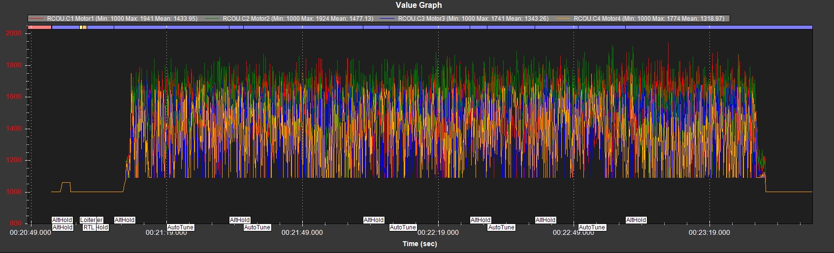

These double-peaks in the noise
are caused by motor mount or frame twist, CCW motors 1 and 2 have to work harder to counteract a twist with motor 3 or 4.

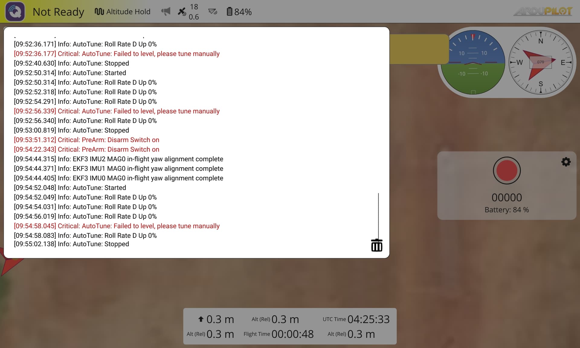

Sorry for the delay. Id changed the parameters as per your guidance. But still Auto Tune is failing. Kindly refer to my Drive link. I have uploaded the Auto Tune Fail flight log.

You need to change the parameters AND fix the twisted motors.

There is lots of motor output oscillations, the VTOL Quicktune script would be a good idea.

Sure it is from massive output oscillation as noted. This is what it looks like so you can review the changes suggested and see for yourself if they are correcting the problem by graphing these fields.
