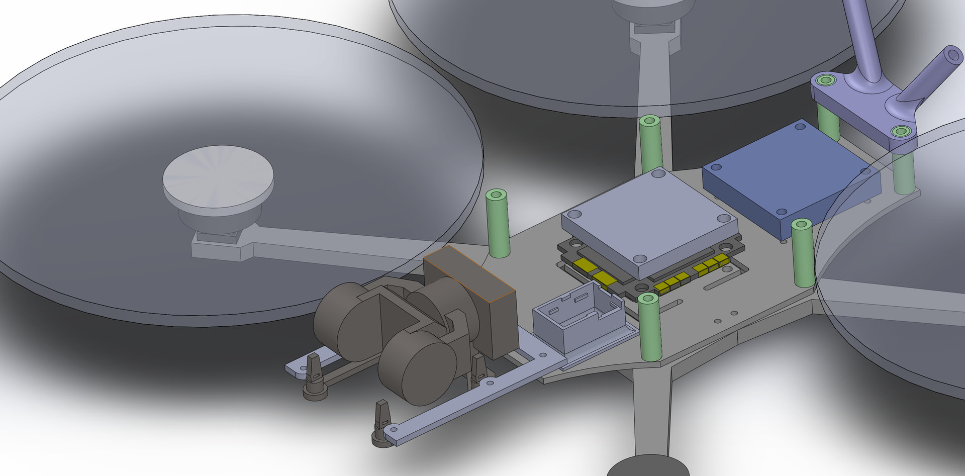

Are long booms on the frame going to cause tuning issues?
I’ve been working on the design for a new drone. The gimbal needs a pair of long booms for the anti-vibration mounts. Are these booms likely to causing tuning issues later ?
I’ve used the one axis version of this gimbal before and it seems to work with a simple rigid direct mount to the air frame as well, so I could do away with the booms and anti-vibration mounts.
They may introduce unwanted vibration modes. Depending on their stiffness and loading.
