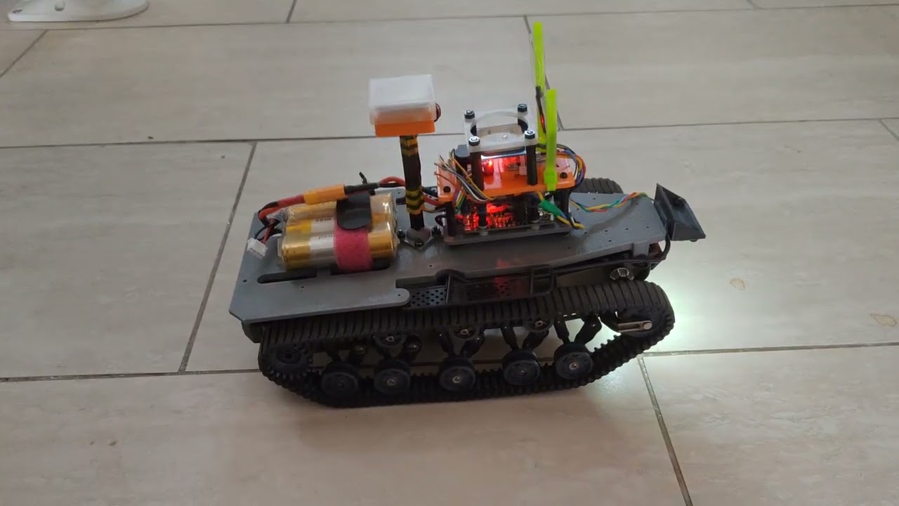

I’m having a bit of an issue with a simple ardurover that I’ve built. It’s based on a cheap rc toy (JJRC C8812). It’s a tank tracked vehicle driven by 2 brushed ESCs (actually a 2in1) with one motor driving it forwards and another for steering, arranged through a gearbox. This is a strange setup but the net result is that it isn’t setup as skid steer - ardurover sees it as one output for forwards / backwards and another for steering.
The problem I have is that everything works great in manual mode. The tank moves forwards / backwards and steers as expected. In any of the other modes including ‘acro’ mode the tank moves forwards and backwards fine but will only steer correctly when it’s moving. If I try to steer on the spot half the time it goes the wrong way, jitters, then tries to correct by going the other way.
I’ve calibrated the compass multiple times and it has made no difference to the behaviour. I’ve double checked compass and AHRS orientation. I’ve played with the PIDs. If I move the tank indoors so that it loses all GPS satellites then it starts steering properly in acro mode and the problem goes away until it reestablishes a good satellite connection.

The Rover documentation presents 2 fundamental options for configuration: Separate steering & throttle, and Skid steering. Yours does not seem to be either of these. (But it sounds like you’ve configured it assuming the first one.) My recommendation is to somehow solve the discrepancy between what AP thinks your platform is, and what it actually is.

In manual mode, if you move the steering without throttle, the wheels would steer in that direction but the rover would not pivot. Yours happens to actually pivot-in-place. So it does what you wanted, but that’s essentially a lucky accident.
In acro mode, for some reason when the GPS is not healthy, perhaps Rover ‘falls back’ to manual mode. So you get lucky again.
In acro when the GPS is healthy, your “turn the wheels” command leads to physically spinning-in-place. That surprises the controller. So for some reason, it responds by counter-steering, and stuttering, and such. That’s the “does not turn” behavior which is concerning you. But its root cause is that the code with well-defined expectations is being applied to a platform which does not satisfy those expectations.

Thank you to everyone for your advice. I’m working on the basis now that having a skid steer vehicle set to regular rc car mode is what’s confusing the autopilot when it’s in the loop (but not in manual mode). To rectify this I have put together a little bit of software (I call it the rc tank demixer) that runs on a pico2w (the only microcontroller I had lying around) which allows me to run the autopilot in skid steer mode and demix the outputs into steering and throttle for the rc tank’s weird gearbox arrangement.

I’ve just done a proper test drive with my new rc tank demixer device in the loop and i can confirm that all my problems with direction in life (with the tank at least) have disappeared now.
It just needs a bunch of PID tuning so that it steers better but I’ve already had it running a simple GPS waypoint test mission, badly, that it could not run at all with the previous setup.
Short version = ardurover gets confused if you set it up as an rc car without skid steering if the vehicle can skid steer.
Here’s a picture of the ardutank as it currently stands. With added purple to replace the grey bit I broke. Mavlink connection with the laptop via ExpressLRS and wifi, which now works quite well apparently. I’ll have more fun playing with all that now that the thing drives itself properly. Thanks again for everyone’s help.

where it breaks down is the fact that Ackerman will reverse its direction of rotation when it changes it direction of travel. so when going forward in a car and you steer right the car will rotate clockwise, but when you reverse and steer right the vehicle will now rotate anticlockwise, this is different to a tracked vehicle where steering right will always rotate to the right independent of direction of travel.

That reversing of travel thing certainly explains why the vehicle was turning one way then the other while stationary.
Definitely getting there with the PID tuning now it basically drives OK. I also added some old school analogue video gear.
