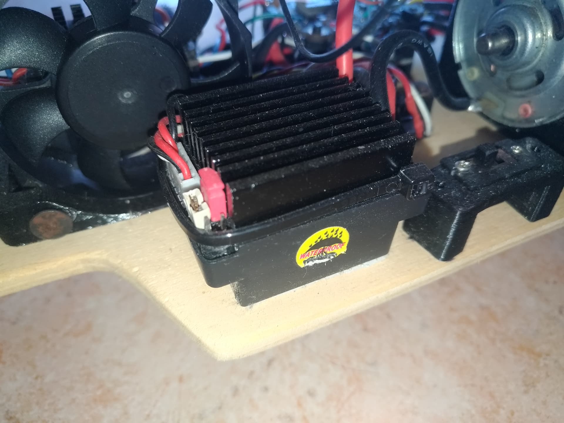

The picture is nice but with such a pic I am not able to identify which ESC you are using.
So please write as the model, brand, manufacturer of your ESC. and how it is connected to your FC.
We ar e onl able to read and see what you present. We are not able to see what is on your bench.

It is a cheap brushed esc purchased many years ago. Unfortunately, I cannot know the brand and model. When connected to a 1500mms to 2000mms PWM RX carried forward, 1500 to 1000 reverse or brake depending on how it is programmed. The esc works with a single wire connected to a fc pad (tomorrow I’ll disassemble and give you all the information on the connections.) anyway, the esc works well I tried it today with an rx pwm. Thanks again and sorry if I’m not very precise…
