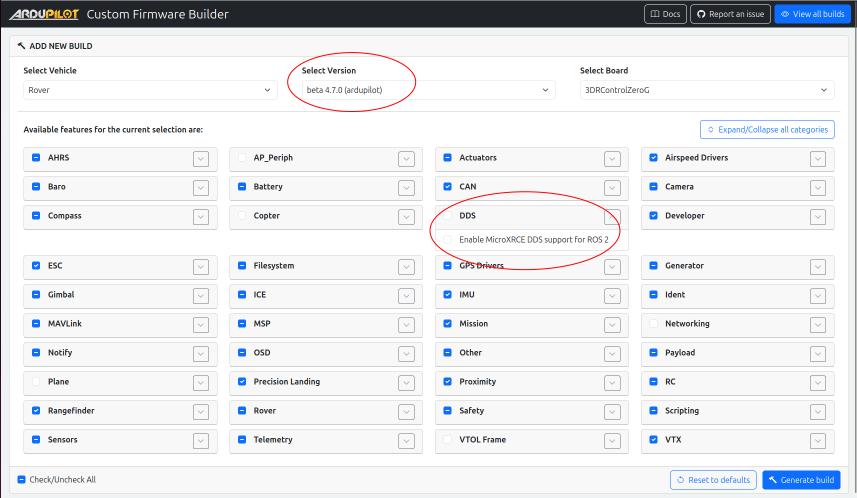

Reason for using 4.7.0 is that for that firmware I could manage to get MicroXRCE DDS for ROS2 working, as that is important for my project. If I am mistaken and DDS ROS2 interface is available for stable rover firmware, please let me know, but I could not find DDS enable options for any other firmware on https://custom.ardupilot.org/.

To clarify, it DDS is supported on the build server for version 4.7 and later. So you’ll need to switch to the beta builds until 4.7.0 is released:

Thank you for confirming DDS as an option for 4.7.0, since the UM982 is working now, I will remain on this version. Can’t wait for the full release!
