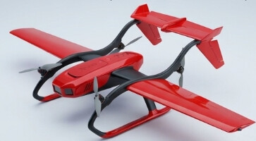

1. Aircraft Configuration
I am working with a hybrid VTOL drone that combines a fixed-wing aircraft and quadcopter configuration. The aircraft uses a tailsitter VTOL configuration.
The aircraft has the following characteristics:
  • Hybrid VTOL/fixed-wing configuration.
  • Quadrotor motor arrangement for VTOL operation.
  • The motors are mounted in an angular/tilted rotor configuration rather than being perfectly vertical.
  • The fixed-wing configuration does not use conventional aerodynamic control surfaces such as ailerons, elevator, or rudder.
  • The aircraft uses a full-lift body configuration, meaning the body/airframe itself generates the aerodynamic lift.
  • Control during fixed-wing flight is therefore expected to be achieved primarily through differential motor thrust / motor control, rather than conventional control surfaces.
I have attached an image of the aircraft/motor configuration for reference.

5. Current Motor Tilt / VTOL Configuration
Because of the physical motor mounting angle, we have had to compensate for the motor orientation during VTOL operation.
For VTOL operation, we currently use:
Q_TRIM_PITCH = -50
The reason for this value is the physical motor tilt angle.
During VTOL takeoff, the motors initially operate according to the VTOL configuration. As the aircraft transitions, the motors are expected to rotate/align toward the fixed-wing thrust direction.
Due to the motor mounting angle, the aircraft naturally tends to pitch upward slightly during the VTOL phase, so Q_TRIM_PITCH was adjusted to compensate for this behavior.
6. Fixed-Wing/Tailsitter Angle Configuration
For the fixed-wing configuration, we are currently using:
Q_TAILSIT_ANGLE = 30
The intention of this setting is to compensate for the physical geometry of the aircraft during the transition to fixed-wing flight.
When the aircraft reaches the fixed-wing orientation, the aircraft should become approximately level.
With the current mechanical configuration, the front motor moves downward during the transition, while the aircraft body rotates toward the normal fixed-wing flight attitude.
Therefore, we selected Q_TAILSIT_ANGLE = 30 based on the required physical orientation of the aircraft.

“I checked your log, and you did not configure this parameter: Q_TAILSIT_MOTMX.”
Hi @weave_alan
Thank you for your time and response.
But as per the Arducopter document, it’s required only for 4.1 and earlier versions, not for the new one, because I’m using 4.6.3 now. It’s mentioned, “With firmware 4.2 and later, for this configuration, use Q_TAILSIT_ENABLE = 2 which forces QASSIT all the time. Q_TAILSIT_MOTMX is ignored in that case.”
“(firmware 4.1 and earlier) it is possible to have a CopterMotor Tailsitter using no fixed wing control surfaces, ie basically a quadcopter with a wing. For that configuration, all Copter motors would be set to be active in fixed wing modes via Q_TAILSIT_MOTMX and Q_OPTIONS bitmask would have bit 7 (Force QASSIST) set to have QASSIST active in all modes. With firmware 4.2 and later, for this configuration, use Q_TAILSIT_ENABLE = 2 which forces QASSIT all the time. Q_TAILSIT_MOTMX is ignored in that case.”
here is link : Tailsitter Planes — Plane documentation
