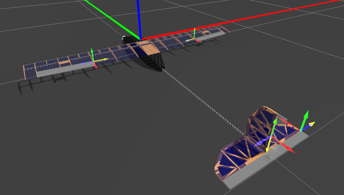

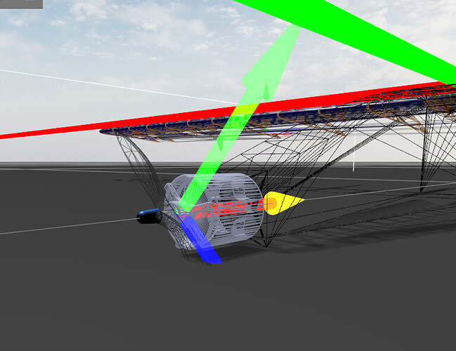

ArduPlane + Gazebo (Ignition) – PreArm “Accels inconsistent” with custom fixed-wing model and LiftDrag
I am working on a fixed-wing aircraft model in Gazebo (gz-sim) integrated with ArduPilot SITL.
The model is inspired by and written based on the ArduPilot Talon fixed-wing example, adapting its overall structure, control surfaces, and plugin configuration.
I am currently experiencing issues where the aircraft does not generate sufficient forward acceleration and lift to take off. I suspect the problem is related to thrust modeling and lift/drag axis definitions, rather than control logic.
Can you help me identify where I went wrong and pinpoint the weak points in my setup?

    <plugin filename="gz-sim-lift-drag-system"
        name="gz::sim::systems::LiftDrag">
      <a0>0.3</a0>
      <alpha_stall>1.4</alpha_stall>
      <cla>4.25</cla>
      <cda>0.10</cda>
      <cma>0.00</cma>
      <cla_stall>-0.025</cla_stall>
      <cda_stall>0.0</cda_stall>
      <cma_stall>0.0</cma_stall>
      <area>0.05</area>
      <air_density>1.2041</air_density>
      <cp>0.084 0 0</cp>
      <forward>0 1 0</forward>
      <upward>-1 0 0</upward>
      <link_name>propeller_link</link_name>
    </plugin>
      <a0>0.3</a0>
      <cla>4.25</cla>
      <cda>0.10</cda>
      <cma>0.00</cma>
      <area>0.05</area>
      <cp>-0.084 0 0</cp>
      <forward>0 -1 0</forward>
    </plugin>
    <!-- left wing -->
      <a0>0.13</a0>
      <cla>3.7</cla>
      <cda>0.06417112299</cda>
      <cma>0</cma>
      <alpha_stall>0.3391428111</alpha_stall>
      <cla_stall>-3.85</cla_stall>
      <cda_stall>-0.9233984055</cda_stall>
      <cma_stall>0</cma_stall>
      <cp>0 0.27 0.029</cp>
      <area>0.16</area>
      <forward>1 0 0</forward>
      <upward>0 1 0</upward>
      <link_name>base_link</link_name>
      <control_joint_name>left_aileron_joint</control_joint_name>
      <control_joint_rad_to_cl>-0.75</control_joint_rad_to_cl>
    </plugin>
    <!-- right wing -->
      <a0>0.13</a0>
      <cla>3.7</cla>
      <cma>0</cma>
      <cp>0 -0.27 0.029</cp>
      <area>0.16</area>
      <control_joint_name>right_aileron_joint</control_joint_name>
    </plugin>
