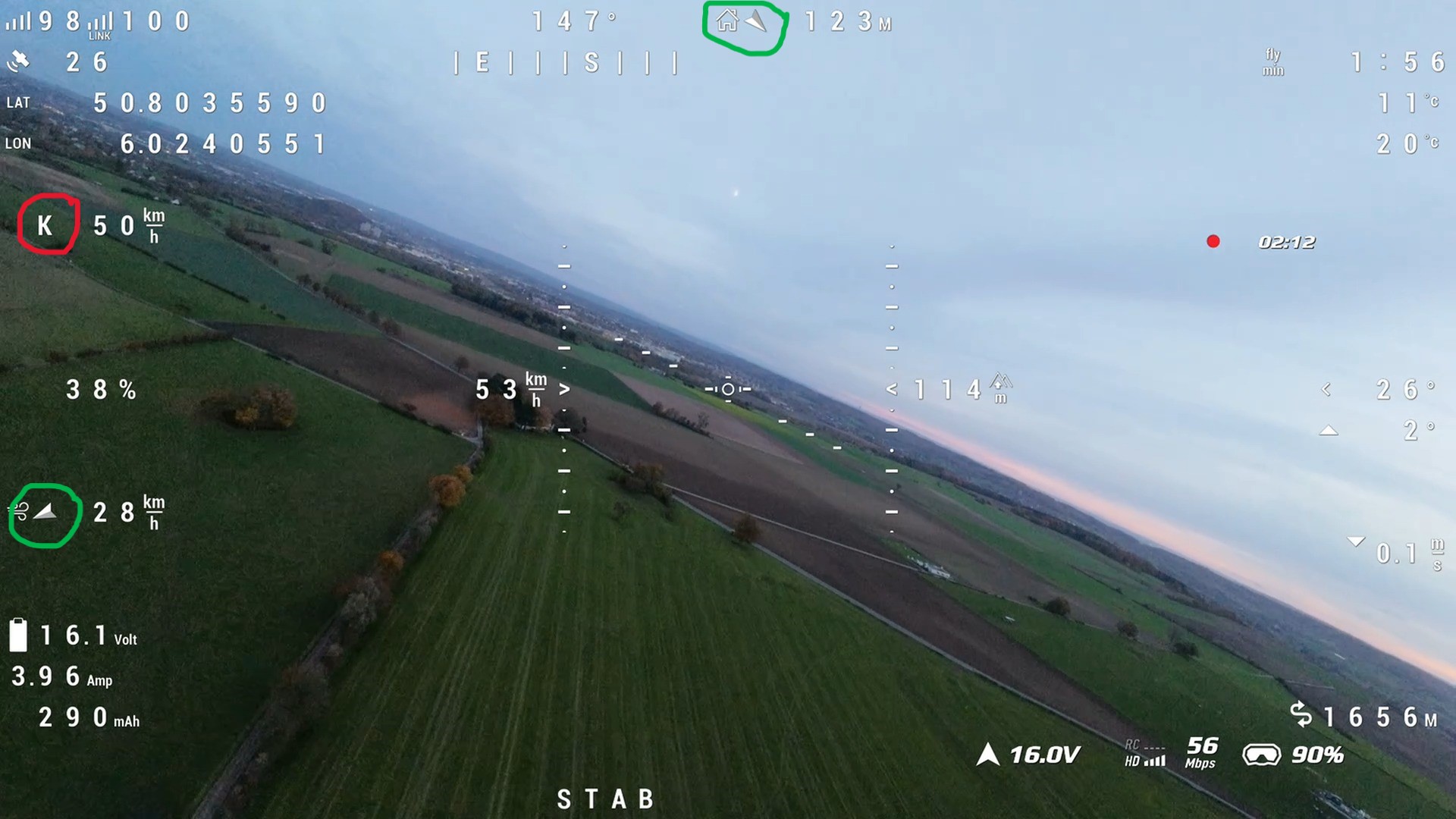

Arduplane Beta 4.6.3 bug with Arrow at 11:00 using INAV Font with DJI O4 Pro and Goggle N3
there appears to be a bug when using INAV fonts in the OSD with DJI O4 Pro and Goggle N3:
The MATEK 743-WLITE was flashed with V4.6.3 Beta.

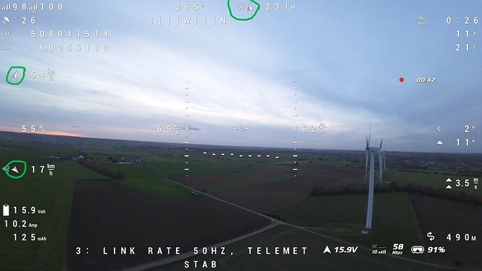

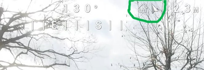

MSP_OPTIONS = 9 enables INAVfonts and all OSD items are working fine with DJI O4 Pro. The arrows for GPS speed direction, wind speed direction and home direction point towards the correct direction.

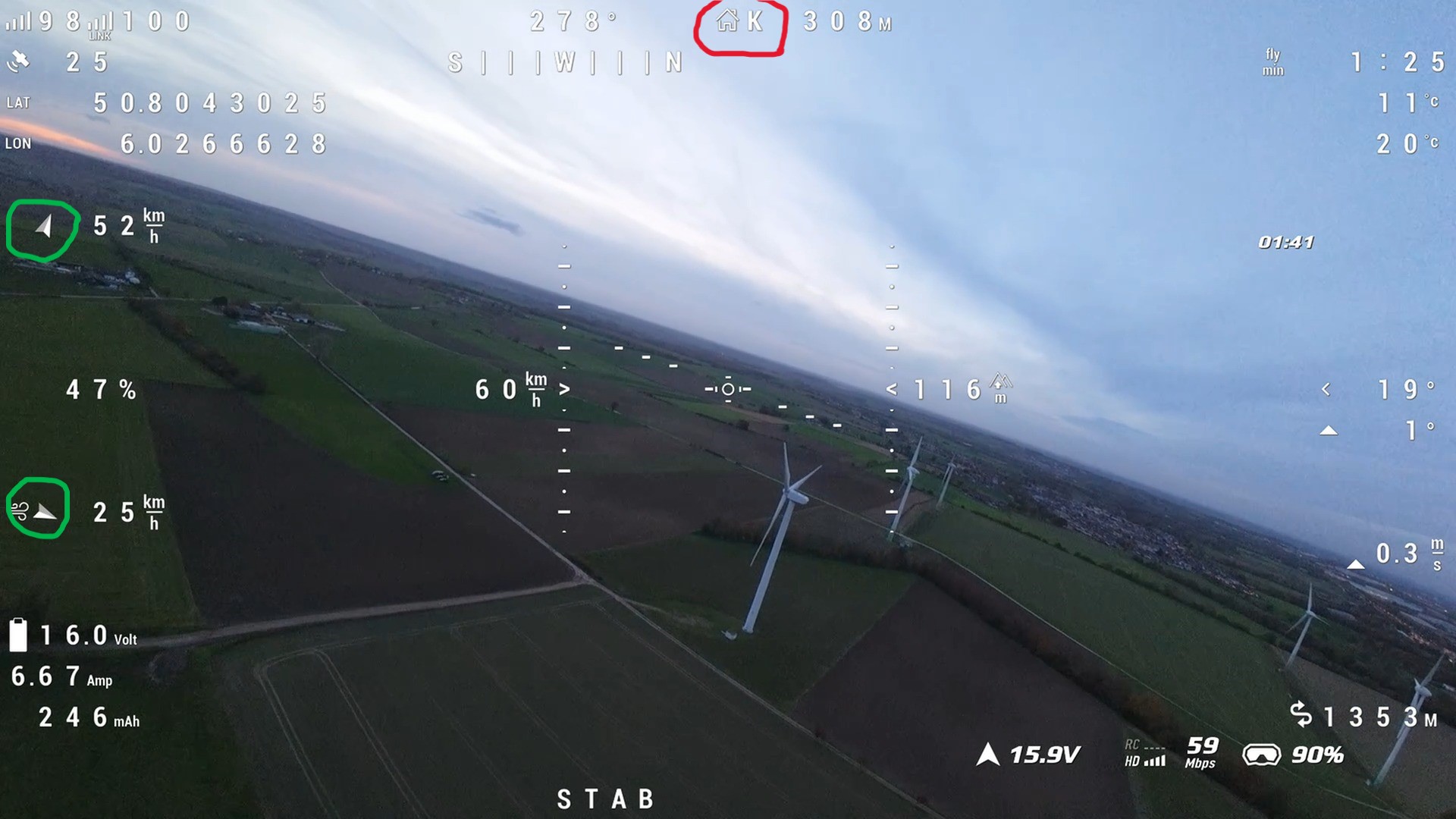

The problem occurs with all three arrows when pointing towards 11:00. In this case the arrow is depicted as a capital “K”. This does not occur when using betaflight fonts.
The picture mark the correct arrows as well as “K” when the arrow is pointing towards 11:00.
the issue has now been resolved in the latest DEV version.
