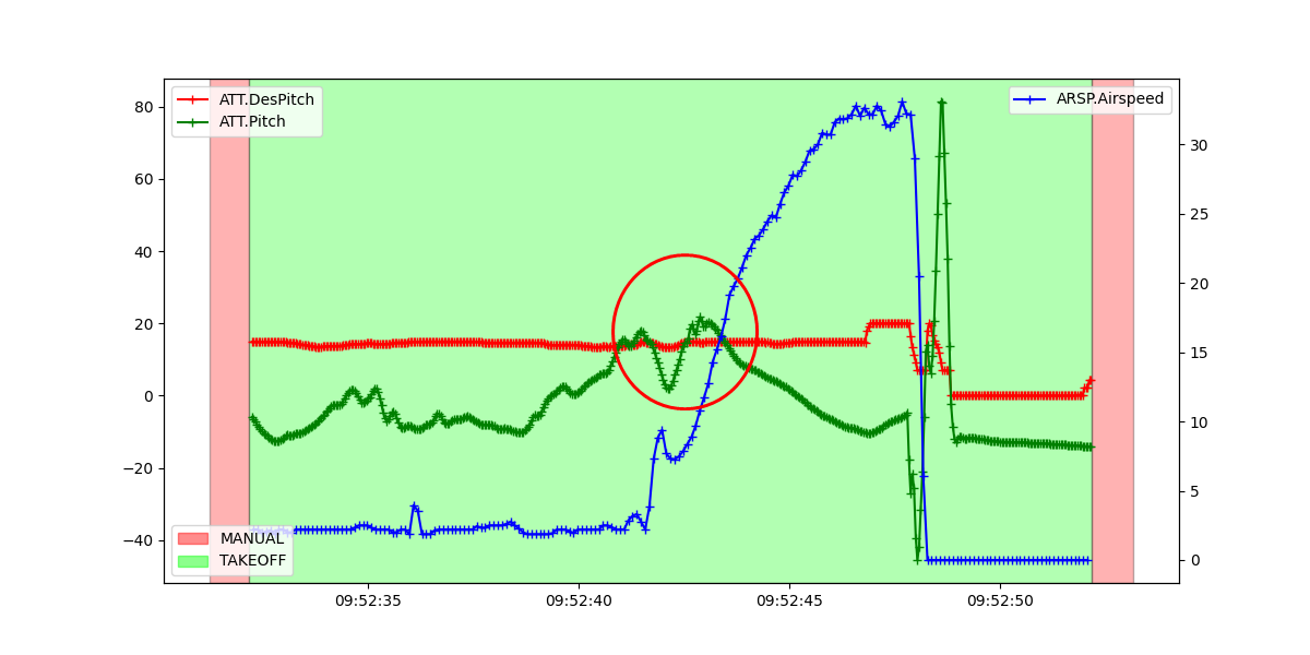

In both logs, during TAKEOFF mode:
  • ATT.Pitch never reaches ATT.DesPitch
  • The aircraft does not seem to track the demanded pitch during TKOF
  • Later, when I switch to FBWA/FBWB, ATT.Pitch tracks ATT.DesPitch normally
So it seems the issue is specific to TAKEOFF mode behavior, not general control authority.

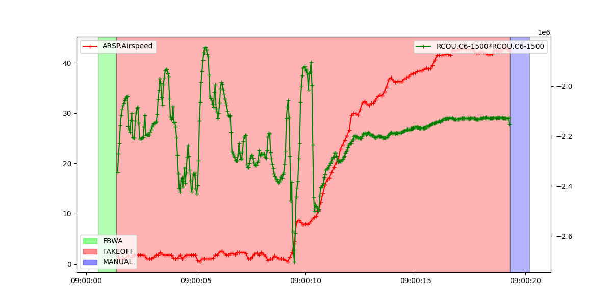

Just an idea after looking to your second log.
During Auto Takeoff Mode our throttle goes to maximum, after you switched to manual and later the throttle never reach this high value. So it could be that your props goes simple to stall during your launch, so it don’t produce forward force, on switching to manual the throttle goes down and the prop comes out of stall than you rises throttle slow but not never to maximum

However, what I’m seeing in the TKOF logs/charts is:
  • For essentially the entire TKOF segment, ATT.Pitch stays below ATT.DesPitch (never reaches the demanded pitch).

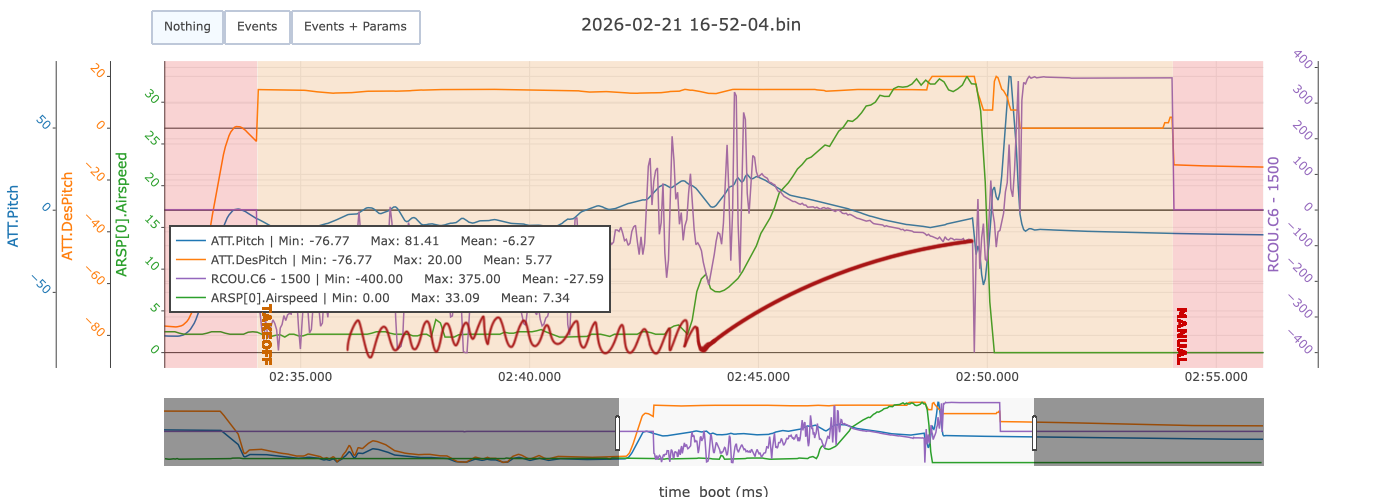

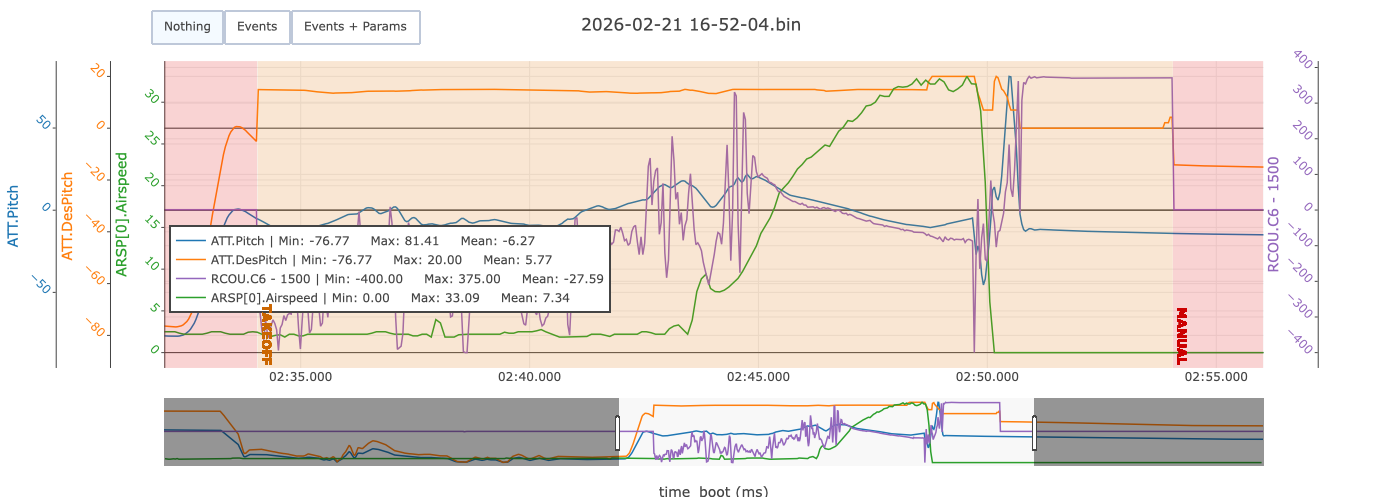

  • But the elevator outputs (C5/C6) go from “down / weak” toward only a slight “up” as speed increases (C6 only gradually moves below 1500us).
  • I expected the opposite behavior: at the very start (low speed + large pitch error), the elevator should command a relatively strong nose-up (especially if the scaler > 1 when below SCALING_SPEED), then back off as speed increases. I draw on the chart with red line by hand to show what I expect C6 output
So I’m worried there is something else limiting or overriding the TKOF pitch controller response during launch.
Thanks again!
Oh, I see the speed is increasing fast during launch so it might not be the props stall problem.
I know. Just to be clear, I only showed C6 to illustrate the amplitude of the deflections.
Correct.

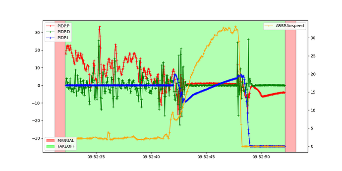

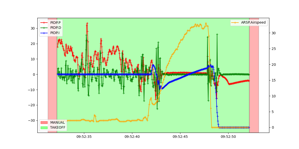

That’s incorrect. After you threw it, the plane did indeed correct for pitch deviations from desired pitch. See the red circle in the graphic.But only while the plane was flying slowly.
Did you set the PID yourself or use autotune? Since there were no more rapid pitchchanges, the slow integral component is now mainly responsible for the control. This indicates a poor PID setting. (If you had thrown the plane from a tall tower, it would have shot up into the sky for a moment and then, being far too sluggish, would have nosedived again)
