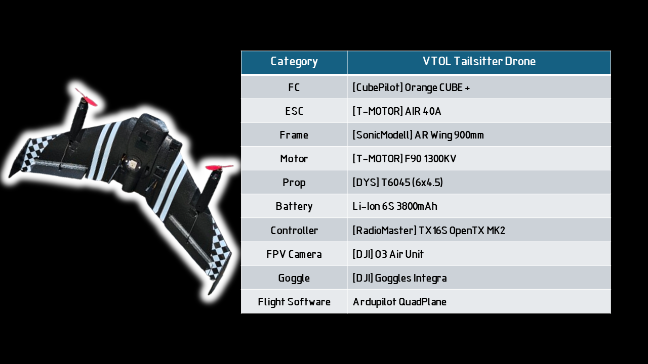

Hello, RC fixed wing VTOL Tailsitter renovation project.
It was made by remodeling the SONIC MODELL AR WING 900mm airframe.

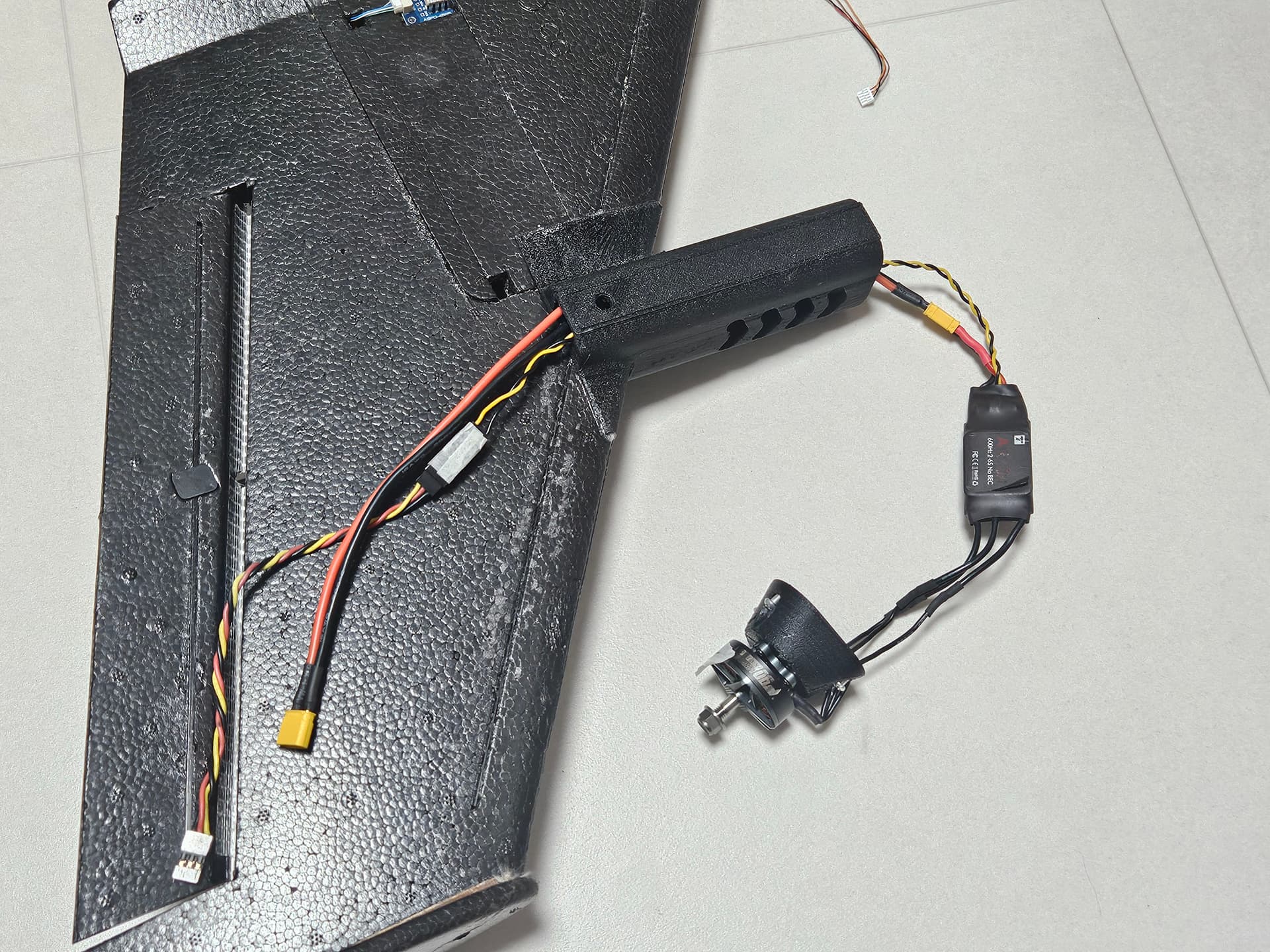

The motor mount was designed and manufactured with a 3D printer.
The attachment position of the motor mount was located in the middle of the elevon and attached to both wings. I thought that only then, the rear flow of the propeller could have a big impact on the elevon.

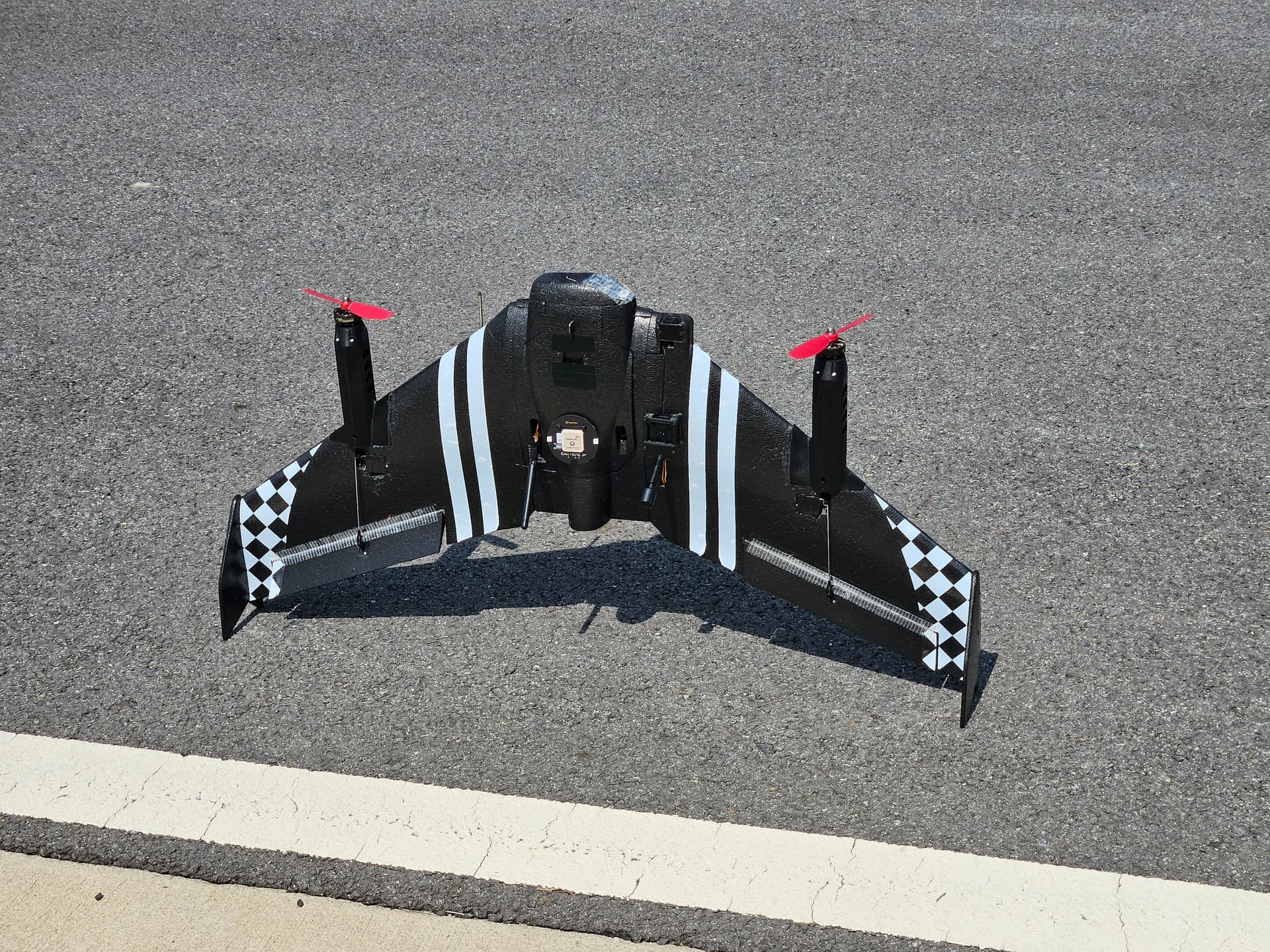

I finished two flights with the plane that was built like that.
First of all, it’s a successful flight video.
The video above is a simple production process and a successful flight.
The first flight mode was Q_Stabilize mode. (First video 3:10)
When it first takes off, the aircraft tilts and waddles to go forward.
This seemed to be controlled so that the drone would not tilt further because it had achieved its maximum lean angle.
