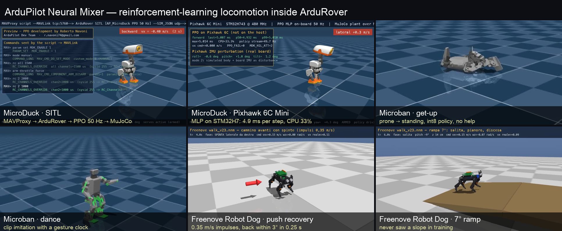

MicroDuck: SITL, then a real Pixhawk 6C
The first robot was MicroDuck, using Pollen’s published PPO policy. The MuJoCo plant talks to SITL over the SIM_JSON protocol, and a scripted MAVProxy session arms, stands, walks forward, backward, sideways, turns 90°, goes to HOLD and disarms:
Then the same network on hardware. Pixhawk6C-NNMixer is a dedicated ArduRover target for the STM32H743; MuJoCo simulates only the robot body and exchanges state and SERVO_OUTPUT_RAW over MAVLink USB, while the board’s real IMU is fed in as a disturbance:
Pixhawk 6C Mini, float32 MLP in flash
Forward pass at 50 Hz p50 4.9 ms, p99 5.0 ms
Autopilot CPU load 32.8 % (5.4 % with NNMixer disabled)
Flash 1,947,204 B used, 18.9 KB free (Pixhawk6C-NNMixerSD, SD policies only: 811 KB free)
HIL battery (arm, stand, forward, lateral, turn, HOLD, disarm, parity) 8/8 PASS in SITL
Firmware action vs training network max difference 2.7e-7

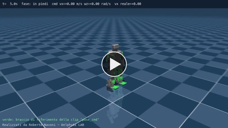

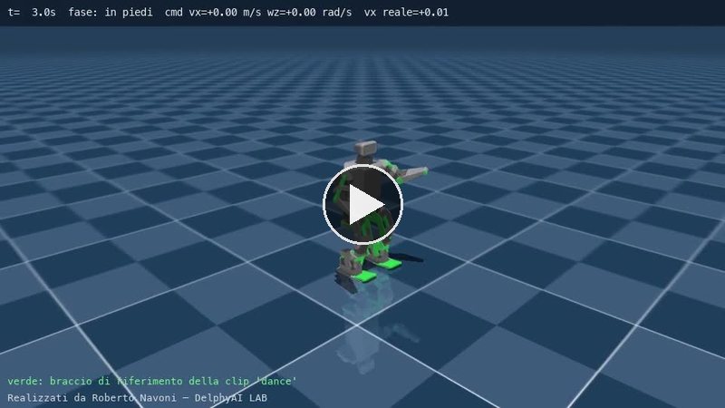

Microban (an 18-servo, 350 g open humanoid) became the test bench for everything a biped does besides walking. The network has no memory, so a periodic gesture needs a clock: two extra observation channels carry the sine and cosine of a phase, generated by the firmware from NNM_CLOCK_HZ. Training then imitates a reference clip (the DeepMimic recipe, as in Xue Bin Peng’s MimicKit): the reward is how close the clip’s joints are to the pose of this phase. A wave converged in 300 iterations, a full-body dance in 400.
Microban dance
Pose teleoperation over MAVLink. A ground station runs MediaPipe on a webcam, retargets the person’s arms and knee bend to eight numbers and sends them in a DEBUG_FLOAT_ARRAY named NNM_POSE. The firmware low-passes them, applies a watchdog (NNM_POSE_WD) and copies them into the observation; pose_cmd.nnm executes the pose while keeping balance. All the intelligence stays on the GCS.
Microban pose teleop over MAVLink

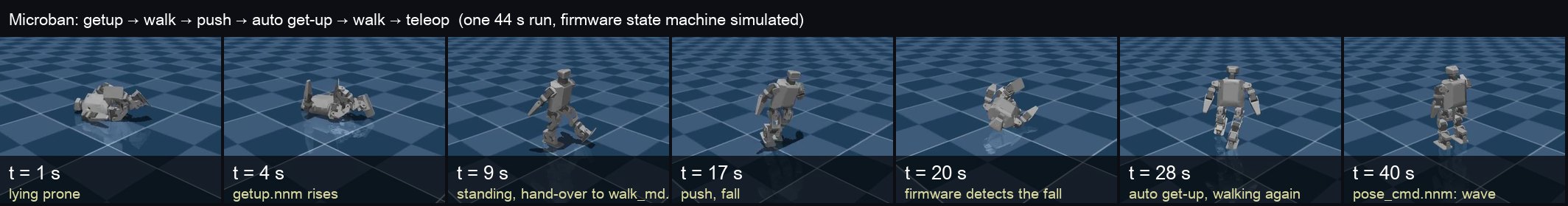

Getting up. A biped that cannot stand up after a fall needs a human within arm’s reach. getup.nnm is a one-shot policy: the firmware detects the fall from the trunk tilt, switches to it, runs a 14.2 s clock once (NNM_GETUP_S) and hands control back to the previous policy when the robot is upright. It was trained in two stages: a discovery policy finds a way to stand (simulation only, with a decaying helping force on the trunk), the best rollout is recorded, slowed down and blended into the standing pose, and a second policy imitates that clip in closed loop. Int8, from prone 100 % of the time (4–11 s), from supine 100 % (1.5–3 s), and the walking policy takes over 100 % of the time.
Microban get-up storyboard
That run is one continuous 44 s sequence with the firmware state machine simulated: get up from prone, cross-fade to walk_md.nnm, walk, get pushed, fall, automatic get-up (side chosen from gravity), walk and turn again, stop, then pose_cmd.nnm waving. Details and the dead ends (joint-only imitation never stood up; a 10° upright gate taught the robot to lock its knees) are in gesture_imitation.md.

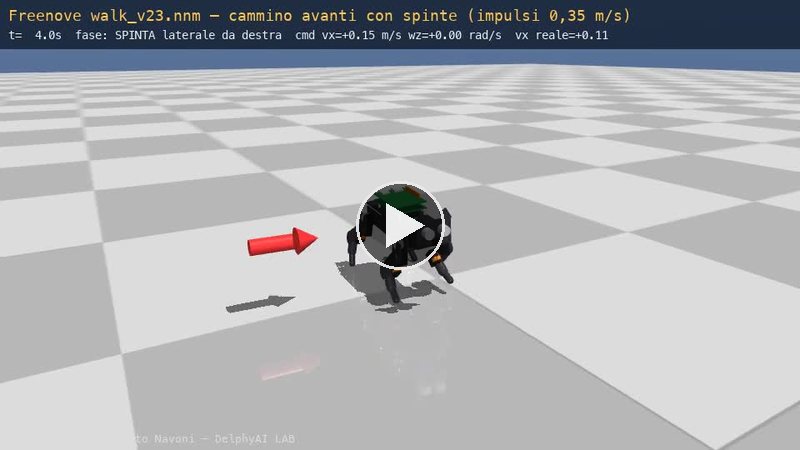

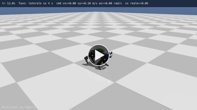

A quadruped: Freenove Robot Dog
Same firmware, same trainer, four legs. The Freenove Robot Dog (12 PWM servos, so it can plug straight into the autopilot outputs) went through 23 environment versions; walk_v23.nnm trots at about three touchdowns per leg per second with 150 ms flight phases, trunk oscillation 1.2°, 100 % survival.
Freenove trot Freenove push recovery
Full sequence: 2.67 m, straight within ±2°, 180° turn in 4.6 s Four 0.35 m/s impulses (7× the training ones): trunk back within 3° in 0.25 s
The ramp is 7°, up and down with yaw correction. At 10° it stalls halfway: it never saw a slope in training. Honest limits are in every robot page next to the videos.
