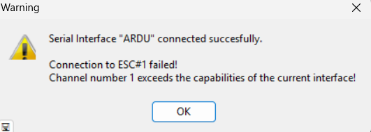

I’m getting these popup windows in BLhelisuite.
No ESC data.
I have also tried this online configurator, this is also not reading any of the ESC.

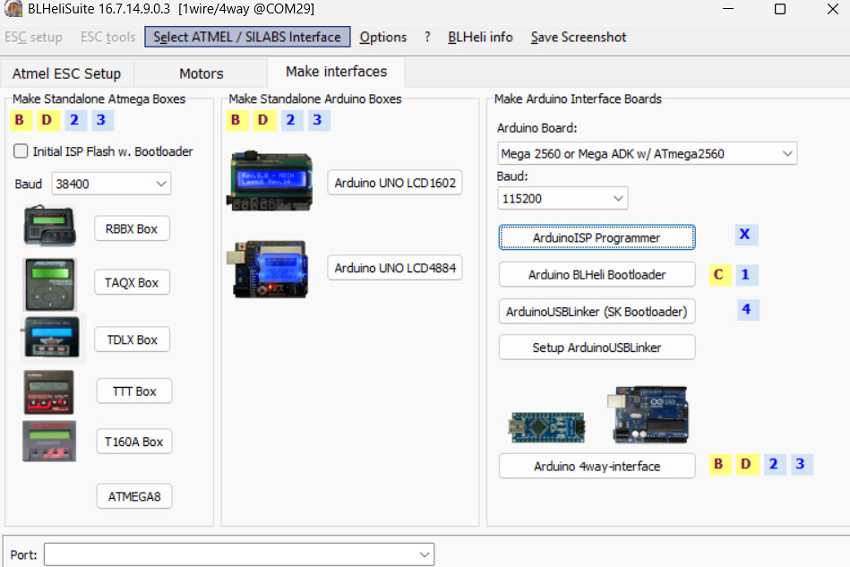

Can you try all interfaces? If all else fails, you can still try to connect them using an Arduino. I currently don’t have the BLHeli Suite installed, so I don’t remember exactly which interface worked for me
Ok thank you for the reply.
I have Arduino mega, so tell me what should i code in this Arduino so that it can detect ESCs
But chances are it won’t work with Arduino if it already didn’t work with passthrough
Have you tried 4.6.3?
Thank you for the help, i have detected all 4 ESCs using Arduino. Now Im capable of reading all ESCs data.
