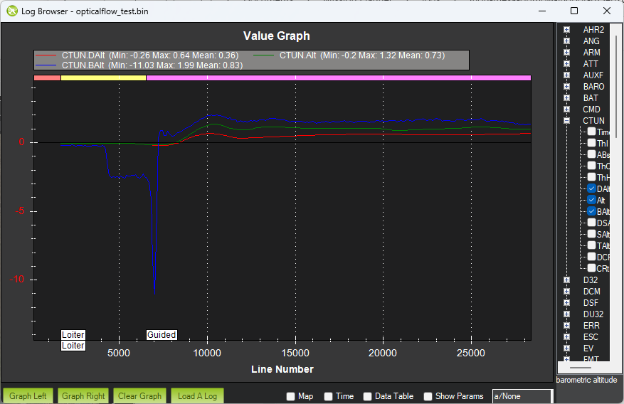

Hi @jhon_mesa,
Probably the first step to resolving this is to try and clarify if it’s an estimation problem (e.g. sensors, EKF) or control problem (e.g. PID tuning).
It looks like during takeoff there is 11m of baro disturbance which is quite large. I think it could help to increase the length of the legs.
The EKF alt estimate also stays quite far from the barometer alt which (combined with the above) I think points towards an estimation problem.
As a test, you could try flying in Loiter instead of Guided to see if that helps. The might work better because Loiter’s surface tracking controller will use the rangefinder to essentially override the bad baro based estimate.
We generally don’t recommend using the rangefinder for the EKF’s altitude estimate but if the vehicle is indoors and the floor is flat that could be an option. This can be done by setting EK3_SRC1_POSZ = 2 (rangefinder). We’ve got an issue though when the EKF uses the rangefinder for the alt source which can result in loss of the altitude estimate causing the vehicle to crash into the ceiling if the rangefinder is unhealthy during takeoff. It’s unlikely but we have an issue here that shows it.

Ah, I didn’t notice that the EKF was using the 2nd source set.
It seems that the EKF’s altitude is undershooting the rangefinder’s range especially during takeoff.
Graphing the CTUN desired alt vs actual Alt it doesn’t look like the vehicle is moving up and down between 1.4 and 0.8m so if this is what you’re seeing then we can probably conclude that this is an estimation error.
The altitude estimate comes from the rangefinder + the accelerometers so another possibility is high vibration levels. They’re not terrible although they’re also not great. In particular the X axis (forward back) is a little high. It’s hard to

I’m pretty certain that this is an EKF estimation issue or maybe an issue with the rangefinder.
The graph below shows the EKF’s altitude estimate (in red) and the rangefinder’s altitude (in green). From the description it sounds like the rangefinder is correct.
The EKF’s estimate comes from the accelerometers and rangefinder distance so perhaps the vertical vibrations are throwing off the estimate a bit and increasing the weighting of the rangefinder might help.
Could you try reducing the EK3_RNG_M_NSE parameter value from 0.5 to 0.3 to see if that helps? This will increase the EKF’s trust in the rangefinder.
