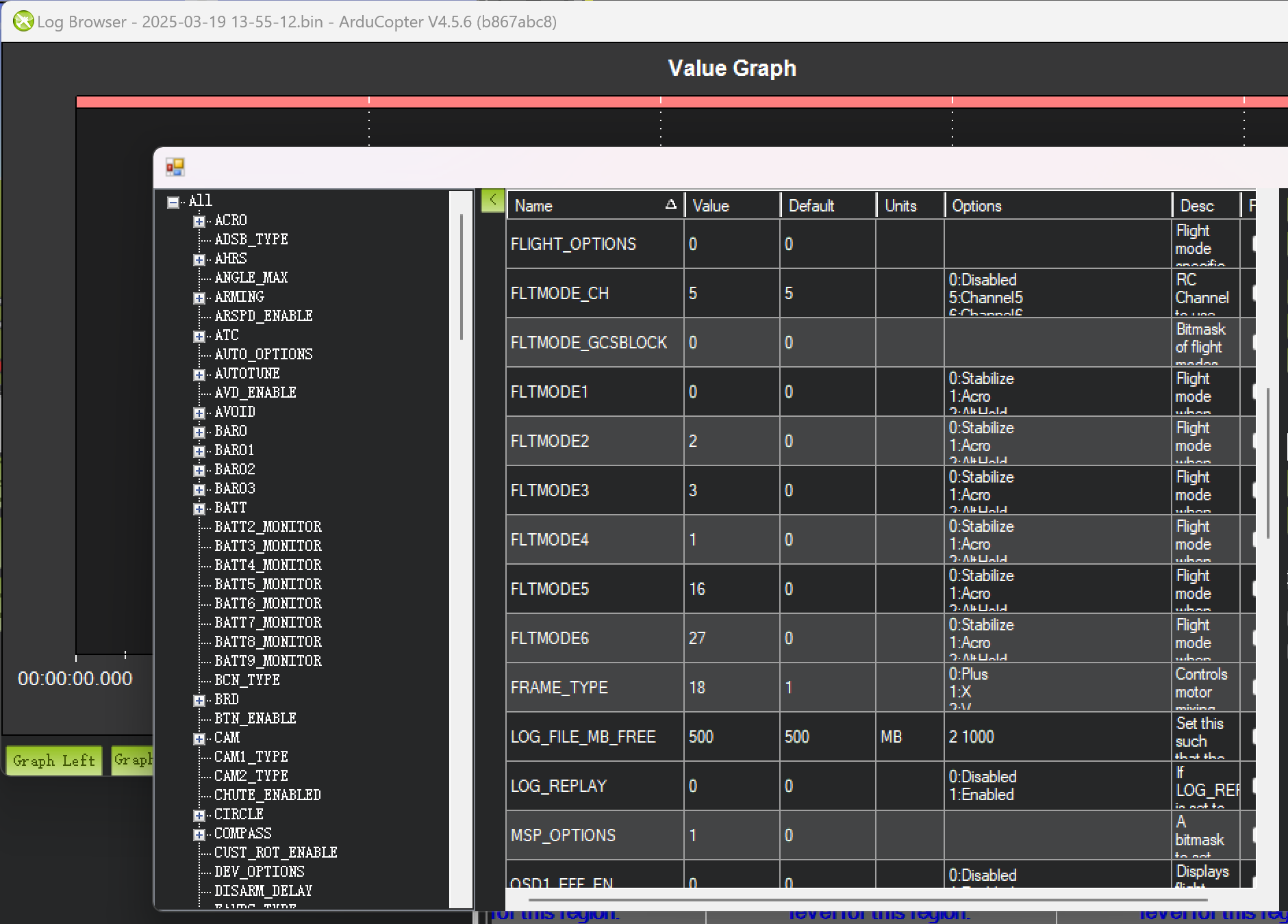

I have met a ‘NO LANDING SEQUENCE’ issue when switch RTL.
Is there any configuration issue that I have unintentionally misconfigured?
BTW: I DID configure a land switch, but I don’t think it has something to do with this. GPS is good, HDOP < 1, mag is OK.
Any idea? Please let me know what you think.

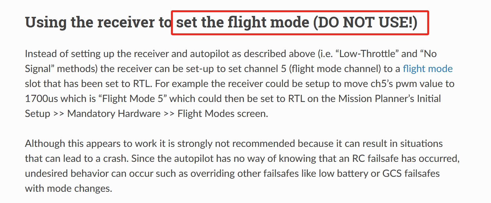

Don’t set flight mode to RTL!!!
https://ardupilot.org/copter/docs/radio-failsafe.html
I think you can and should have a RTL as one of the modes set.
The text you mention says do not cover/hide failsafe with receiver set to RTL on transmission failsafe. Receiver should indicate the failsafe state (with low throttle for example) so AP can manage it.
It seems to me you use AUTO_RTL while should RTL mode.
  AUTO_RTL =     27,  // Auto RTL, this is not a true mode, AUTO will report as this mode if entered to perform a DO_LAND_START Landing sequence

@Paul_Paku Thanks for point out this AUTO_RTL, I think it’s the rootcause (I DID trigger this mode by flight mode switch, see FLGMODE6 = 27, as you mentioned above).
