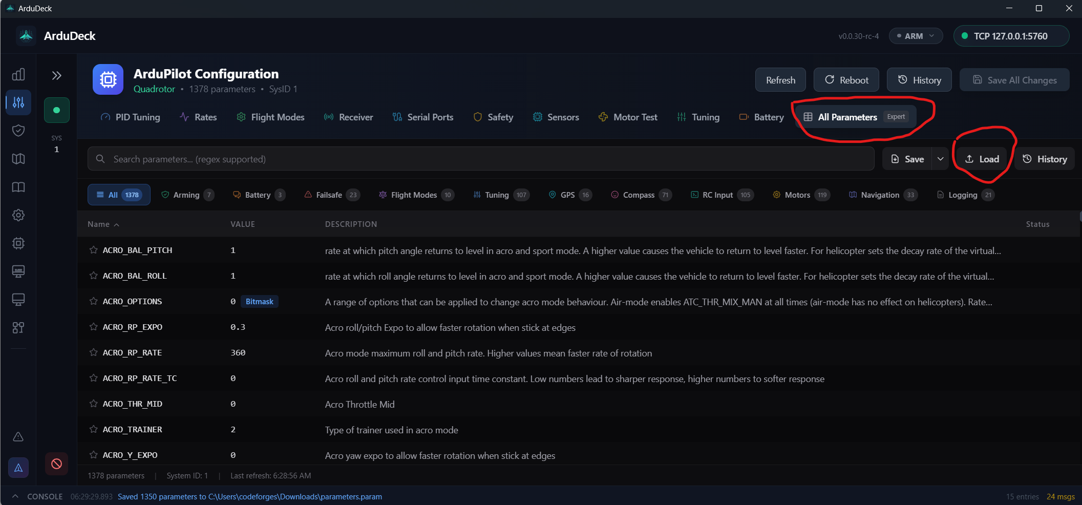

Ok, finally found it - seems loading param file from disk requires being connected to a simulated craft in SITL? I have never used SITL before. If there is an offline mode with no connection at all, I’d probably rather use that.
No you dont need SITL for this.
Simply connect to your FC.
Go to Params → All Params
Press Load → select file and apply
Also Sitl is downloaded once , then you can use it offline.

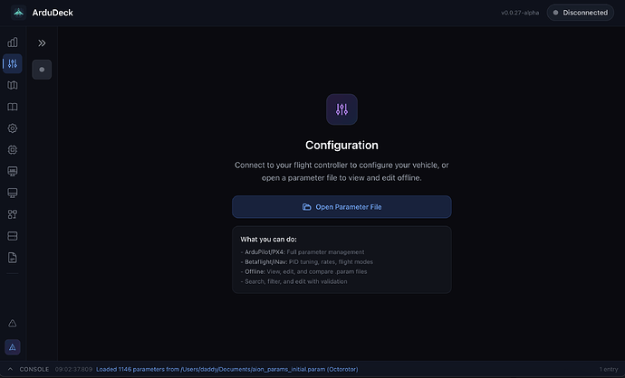

Thanks, but that’s not what I intend to do - I’d like to load params without anything at all connected to USB (‘offline’), for example to check and compare params without having to take the actual copter or plane to my desk.
Of course I can do that with a text editor, but it’s much nicer seeing the params displayed with proper names etc. in a GCS. I’ve been doing that with MP for ages.
And since there never has been a more visually appealing GCS than yours, it would be great if I could do it with it as well.
I see , i dont think there is a problem not to add this , ill add a ticket for that.
Thanks a lot! Is it already included in the currently downloadable version?
