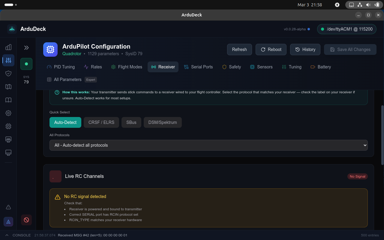

ArduDeck isn’t seeing the receiver. I’m using ELRS RC over Mavlink. It’s properly configured because it works when I check in Mission Planner. AD will detect switch changes when I make them on the radio. it just doesn’t see the sticks so I can’t try out the calibration.
In order to fix this i really need the deckreport file , could you please attach it here/discord or on gh ?
I was meaning to ask if the bug feature automatically sent them in. :slight_smile:
No no no , nothing is send automatically , no hidden logs , telemetry etc.
Im against it a app has to be transparent and no data collection until the users collects it manually.
Thanks for the file and here is your ticket ELRS over Mavlink not working · Issue #56 · rubenCodeforges/ardudeck · GitHub
You can track progress from there.
Proton seems to be giving some grief with that file. Did it work for you? If not I’ll try github.
Seems to be empty , its a compiled and encrypted file of all your app logs and if included board logs.
Just zip it and attach to gh.
No one can open it but me.
Yup, just did it. Let me know if it worked.
Yes , perfect !

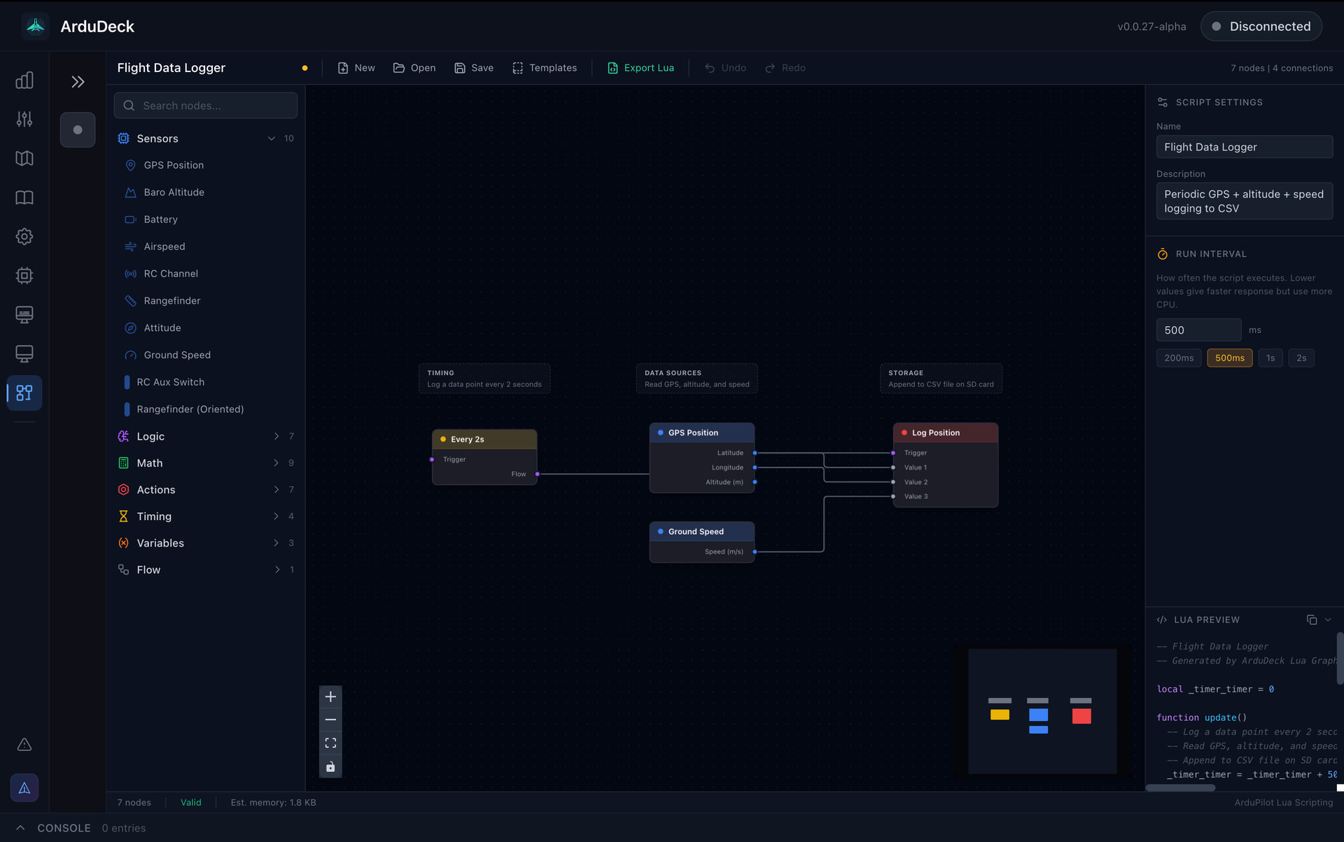

For those of you who really would like to try but where afraid of code , a lua editor is comming in Alpha 29 :wink:
